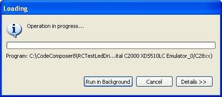

This gives rise to a dialog box:
which looks much like the dialog I got when launching the
debug session, except I cannot give it input focus, I cannot
push any of the buttons visible on the screen, I cannot grab
the title bar & move it around; I can only wait until it
goes away and resume my debug session; which is what I did

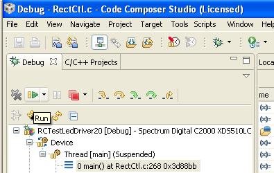

this time. We wind up with the 'Debug' tab visible and the
green 'Run' arrow is not dimmed, suggesting the debugger is
ready:

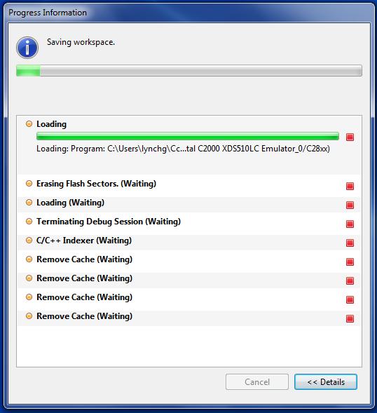

Finally I decide to shut down Code Composer completely,
which gives way to a dialog box that winds up looking like
this:
The pattern of red rectangles suggests that we never made it
to debug mode at all, and much of my recent effort was
meaningless.  I want to know:

  • Hi Gary,
    just a thought/one thing I noticed.  In your screenshot it looks like there is a yellow warning/exclamation mark by device.  Is this correct?  What target are you using/do you have selected? How have you set this up.  I am wondering if CCS is having trouble finding the device/specific device as normally in debug mode you will see the target type.
    Lisa
  • I can't tell where you're seeing this mark. My original post
    has 3 screenshots, and the second contains the word 'Device'
    with a yellow symbol beside it that is below human
    resolution, even on my original screen. I blew that up to
    see the following:
    which I would never interpret to mean a warning.
    Please elaborate.

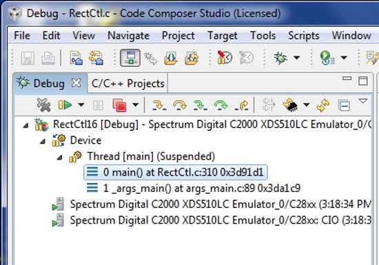

  • Code Composer is going out to lunch often enough now I was
    able to capture a screen shot of it in the state where the
    debugger looks alive, but isn't:
    I then shut the whole app down and started over until I got
    it back in the ready-to-debug state:
    Doing a pixel-by-pixel compare the only difference I see is
    that under the
      "Thread [main](Suspended)"
    string there is only one line instead of two and the legend:
      "0 main() at RectCtl.c:310 0x3d91d1"
    has changed to:
      "0 <symbol is not available> 0x3ffc02"
    I looked those numbers up and according to my .map file
    0x3d91d1 represents the starting address of _main, whereas
    --according to SPRU095C, "TMS320x281x DSP Boot ROM Reference
    Guide", p. 12--0x3ffc02 is an address inside the CPU vector
    table that is never used.
    This difference is significant enough I can avoid making
    this mistake again.
