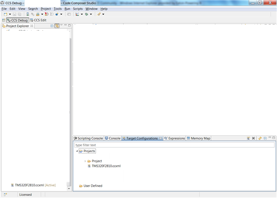

I am using CCS V5.1, and debugging a TMS320F2810 project.  Somehow, a "TMS320F2810.ccxml" debug configuration has become associated with the project.  I don't want that, as I've created my own .ccxml file for this project.  But no matter what tried, I cannot get rid of that TMS320F280.ccxml.  I try to physically remove it from the directories, I try to delete it in the "Target Configurations" menu, etc.  But still comes back everytime I startup CCS V5.1.  Please advise - how to get rid of it permanently?

  • Thanks for the reply.  There was something called a .launch file with name TMS320F2810, when I checked all of the C:\Users directories (Win 7), but no .ccxml files.  I deleted it.  I also deleted TMS320F2810.ccxml once again from Target Configurations.  I then exited CCS, and restarted it.  Exiting CCS saves everything, right?  That is not clear on CCS 5.1.  I think an improvement would be to have a "Save All" or something so the user know thier setup is being saved.
    But when I restarted CCS, once again TMS320F2810.ccxml is listed in my project, as shown below:
    I know how to launch my ccxml file, but wish to have this TMS320F2810.ccxml permanently removed from the project.

  • My apologies, I thought it was in the User Defined location. that persistent ccxml file is in your project folder.
    ...and I see the behavior you describe. Very strange and not what i expected.... need to look at this more.
  • As a workaround for now, make sure the ccxml you do want to use is set to [Active]. This will make CCS use that one instead of the one that keeps coming back.
  • That suggestion is not working.  For explanation: I have 2 projects in CCS V5.1.  Let's call them project A and project B.  project A has A.ccxml and project B has B.ccxml.  Project B also still has TMS320F2810.ccxml.  Project B is the one I am working on now.
    Before trying your suggestion, A.ccxml and TMS320F2810.ccxml were both listed [Active].  When I set B.ccxml to [Active], project A.ccxml still reads as [Active] also.  TMS320F2810.ccxml is not listed as [Active] after.
    Then when I exit CCS, and re-enter, A.ccxml and TMS320F2810.ccxml are once again [Active], and B.ccxml is not [Active].  CCS refuses to remember B.ccxml is the desired [Active].  It also refuses to remove [Active] from A.ccxml, and remove TMS320F2810.ccxml.

    Yeah I found out that this is a known behavior (or bug depending on how you look at it). If you specified a device and connection type when you created the project, it autogenerated a ccxml file for you. The issue is that the project will also manage this file for you in the sense that if it gets deleted, it will regenerated. This is the root issue. This is expected behavior but as you can see, it can cause all sorts of headaches. And on top of it, it keeps re-setting it as [Active]. argh! So in CCSv5.3, there will be an option to disable this auto-regen of the ccxml file.
    Right now, the only way I see to disable this is to change the project properties so that NO connection type is specified in the 'General' options. And to do that you have to change the device Variant to a generic one (like: Generic 28xx Device). Once you do that, it will clear the connection type. And may reset some of the other options (linker command file). But this will prevent CCS from generating a new ccxml file because it cannot do it for generic variants. if I think of a better workaround I'll let you know. Personally I'd probably just launch a project-less debug session and then load my program.

    I think this issue is resolved.  CCS V5.3 will have a better fix, but for now, changing to Generic 28xx Device removed TMS320F2810.ccxml from the project, as desired.  I use my own specific .ccxml anyways, so doesn't matter if overall project is 'Generic'.
