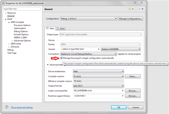

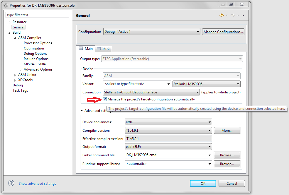

  • Sergei,
    This usability problem has been addressed in the upcoming CCS v5.3.0, which should be available mid November.
    In CCS v5.3.0, you will be able to uncheck the checkbox below...:
    ...and CCS would let you manually manage your .ccxml files, either inside or outside the project.
    Until CCS v5.3.0 becomes available, you can do what John has suggested - create multiple ccxml files in your project, and set one of them as "active" through right-clicking on the ccxml file (not through the Properties > General page).  And on the Properties > General page, set "Connection" to blank (which is the first available field).
    - Baltasar
