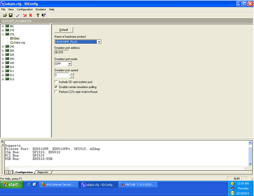

    I am using CCSv3.3. I am using Spectrum Digital's eZDSP which is having on-board JTAG emulation with parallel cable.
    The following is the configuration of target eZdsp with CCS:
    1.First configure Parallel Port in EPP mode in BIOS settings.
    2.On desktop opening SDConfig shortcut and select 378 series and then set Emulator port mode as EPP mode.
    3. Adding eZdsp F2812 in setup CCS 3.3version.
  • If the JTAG IR scan test fails and you cannot verify the connection with the SD Config tool then it should be something related to the emulator cable or eZdsp. See the FAQ on Spectrum Digital's website for more suggestions: http://support.spectrumdigital.com/guides/JTAG_Emulator_guide. You might also want to check with Spectrum Digital in case they have other suggestions for things to check.
