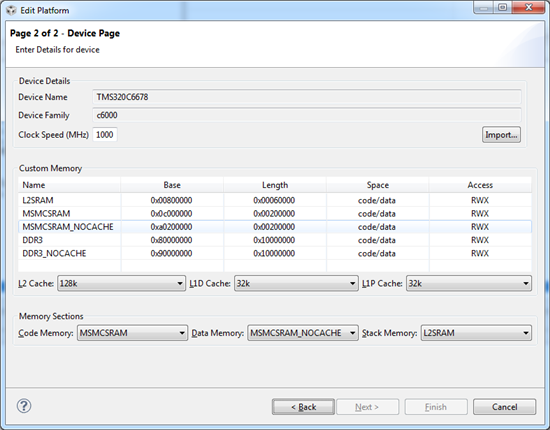

4. Q9: What is DDR3_NOCACHE in demos.image_processing.openmp.evmc6678l.platform RTSC platform as in the image_processing_openmp_evmc6678l? Here, Ajay Jayaraj said that this is from the older version of OpenMP runtime. Q10: Does that mean in the project, we can change
Program.sectMap["ddr"] = new Program.SectionSpec();
Program.sectMap["ddr"].loadSegment = "DDR3_NOCACHE";
to
Program.sectMap["ddr"].loadSegment = "DDR3";
and we can delete the DDR3_NOCACHE in the RTSC platform (DDR3_NOCACHE is as shown below)?
5. Q11: What is the purpose of MSMCSRAM_NOCACHE? Is it similar to DDR3_NOCACHE?
