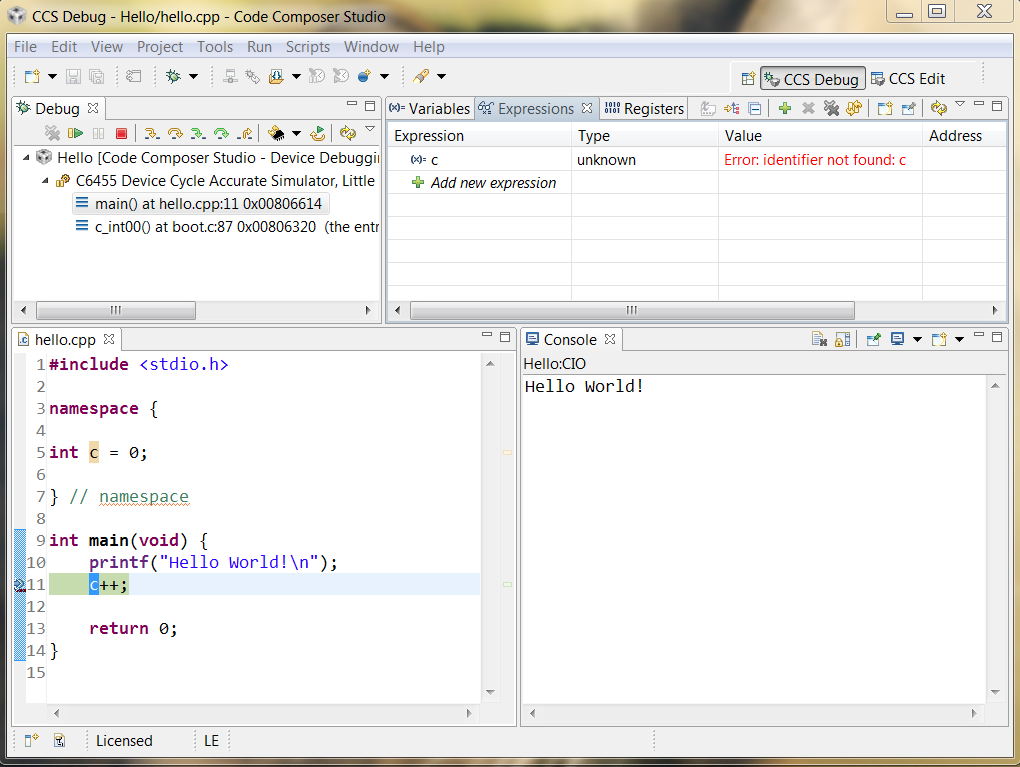

Hello.
When debugging I cannot see variables in anonymous namespace.
Is it bug or feature?

Hi Valery and Alex,
Could you provide a concrete example ?
I write a simple test case and cannot reproduce the issue.
I test it using both TI ARM and GCC ARM compilers.
I have attached the screen to illistrate what I have observed.
The variables defined in the anonymous namespace are only visible when the PC is at the source file where the variables are defined.
-Raymond
I see.
The issue is with variables declared in anonymous namespace.
I can reproduce what you observe.
I also find that we have processed the variables, however, it is renamed to <unnamed>::c as you can see in the attached screen shot of the module view.
I have filed a bug report SDSCM00048546.
I will fix that in CCS v6.
Raymond
For named namespace, you have to prefix the variable with namespace name.
See attached.
As a workaround until this is fixed, you can access variables in the anonymous namespace by prefixing the variable name with ::::
In your example, enter ::::c in the expression view.
You will be able to access the variable.
Raymond
Hi Raymond.
As to named namespace, yet another two examples.
namespace N {
int c = 0;
int main(void) {
N::c++;
return 0;
namespace N {
int c = 0;
void f() {
c++;
int main(void) {
N::f();
return 0;
In both cases I cannot see the "c" value under cursor.
Valery.
For the first case, you have to highlight N::c to see the value of c. see attached.
For the second case, you are right. You should be able to view the value of c when PC is in the function N::f.
I will update the bug to include this case.
Raymond
But all I need to see the field of record is to place cursor over field name, no highlight. The first case is very simillar, isn't it? Debugger can see what I want and does see it in records but doesn't see in namespaces. It's somewhat inconsistently.
Valery.
