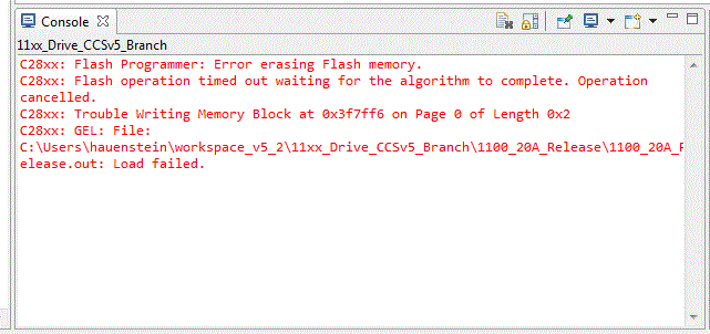

Please help me resolve this issue:
Configuration: CCS 5.2.1.00018, Windows 7 Prof. 64bit, SD XDS510LC Emulator, TMS320F2812 50MHz Clock, PLL = 6.
I am able to load and run programs in RAM using this system.
My Problem: The On-Chip Flash frequency test does not work nor will it Erase or flash a new program. The frequency test does seem start and stop the processor but it's not working.
Using the same emulator and target board, I verified that a frequency test would run and that it could be flashed using a Windows XP machine and SDFlash.
I also just performed a software update on the CCSv5 but problem still persists.
  • Does the programming to Flash on the Windows 7 machine fail with CCS only or also with SDFlash?
    Do you see any error messages during the frequency test or when programming to Flash? If so, what are the errors? A screenshot could be helpful.
    I'm not aware of specific issues related to this emulator and Windows 7 but I'll give this emulator a try with one of my F2812 boards and let you know if I have problems. In the meantime, you may also want to try contacting Spectrum Digital directly (since they are the provider of the drivers) in case they are aware of any issues and have additional tips/suggestions.
  • SDFlash works on the Windows 7 machine. I also verified this issue on another W7 machine. SDFlash works on both W7 machines but CCSv5.2 Frequency test and Flash Programming does not. I'll check with Spectrum Digital as you suggest to see if they may know of something that will help.
    Screen shot of Frequency Test:
    Screen shot after trying to Flash Program:

  • *** CCSV5.2.1.00018 Definitely has an issue with being able to flash a target board if the clock frequency is not the default 30MHz ***
    I replaced the 50MHz clock on my target board with a 30MHz clock. I was then able to flash (30MHz is the default ccsv5 expects and is what is on the ezdsp).
    SDFlash does not have this issue. I am able to program using SDFlash. With SDFlash you use a flash algorithm that has been specifically compiled for your target clock frequency.

    One other thing you could check is the PLLCR register in CCS (from the register view), and see if the value changes to 0x6 after any flash operation.
  • This bug is fixed in CCS 5.4
