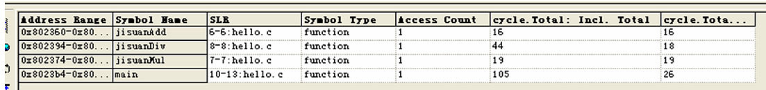

The same C program, when I profile it withe ccs3.2 ccs3.3 and ccs5, I find the execution cycles  become more and more.IS there anything wrong with the CCS version Or I am wrong?

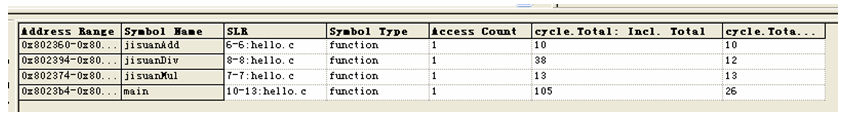

CCS3.2 compile
[hello.c] "C:\CCStudio_v3.2\C6000\cgtools\bin\cl6x" -g -fr"D:/CCC345/Debug" -d"_DEBUG" -mv6400+ -@"Debug.lkf" "hello.c"
[Linking...] "C:\CCStudio_v3.2\C6000\cgtools\bin\cl6x" -@"Debug.lkf"
<Linking>
Build Complete,
0 Errors, 0 Warnings, 0 Remarks.
Below is debug.lkf
-z -c -m"./Debug/CCC345.map" -o"./Debug/CCC345.out" -w -x -i"C:/CCStudio_v3.2/C6000/rtdx/lib" -i"C:/CCStudio_v3.2/C6000/csl/lib" -i"C:/CCStudio_v3.2/C6000/xdais/lib" -i"C:/CCStudio_v3.2/bios_5_21/packages/ti/bios/lib" -i"C:/CCStudio_v3.2/C6000/cgtools/lib"
"D:\CCC345\wei.cmd"
"D:\CCC345\Debug\hello.obj"
"C:\CCStudio_v3.2\C6000\cgtools\lib\rts64plus.lib"
jisuan Add  10 cycles
jisuanDiv 38 cycles
jisuanMul  19 cycles

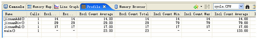

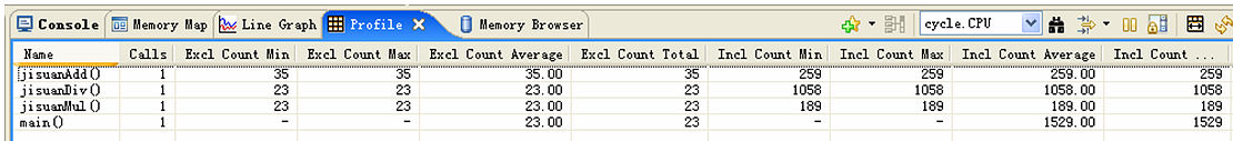

CCS5.0.   Version: 5.0.1.201105110900
**** Build of configuration Debug for project TestFloat ****
C:\Program Files\Texas Instruments\ccsv5\utils\gmake\gmake -k all
'Building file: ../hello.c'
'Invoking: C6000 Compiler'
"C:/Program Files/Texas Instruments/ccsv5/tools/compiler/c6000/bin/cl6x" -mv64+ -g --include_path="C:/Program Files/Texas Instruments/ccsv5/tools/compiler/c6000/include" --diag_warning=225 --abi=coffabi --preproc_with_compile --preproc_dependency="hello.pp"  "../hello.c"
'Finished building: ../hello.c'
'Building target: TestFloat.out'
'Invoking: C6000 Linker'
"C:/Program Files/Texas Instruments/ccsv5/tools/compiler/c6000/bin/cl6x" -mv64+ -g --diag_warning=225 --abi=coffabi -z -m"TestFloat.map" --warn_sections -i"C:/Program Files/Texas Instruments/ccsv5/tools/compiler/c6000/lib" -i"C:/Program Files/Texas Instruments/ccsv5/tools/compiler/c6000/include" --reread_libs --rom_model -o "TestFloat.out"  "./hello.obj" -l"libc.a" "../rts64plus.lib" "../wei.cmd"
<Linking>
'Finished building target: TestFloat.out'
jisuan Add  14 cycles
jisuanDiv 79cycles
jisuanMul  17 cycles

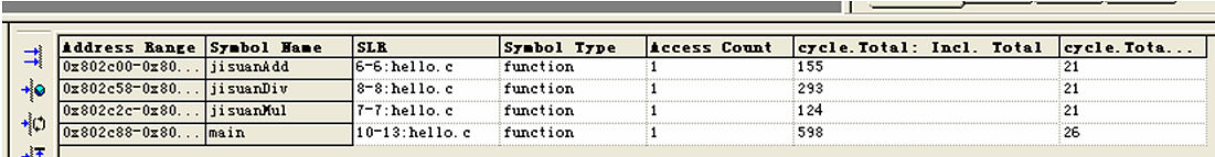

Can get: CCS3.2
jisuan Add  149 cycles
jisuanDiv 287cycles
jisuanMul  118 cycles
CCS5
jisuan Add  259 cycles
jisuanDiv 1058 cycles
jisuanMul  189 cycles
IS THERE SOMETHING WRONG???
The function jisuanDiv execution cycle : from 287 change to 1058.
CCS3.3 compile
-----------------------------  CCC345.pjt - Debug  -----------------------------
[hello.c] "C:\CCStudio_v3.3\C6000\cgtools\bin\cl6x" -g -fr"D:/CCC345/Debug" -d"_DEBUG" -mv6400+ -@"Debug.lkf" "hello.c"
[Linking...] "C:\CCStudio_v3.3\C6000\cgtools\bin\cl6x" -@"Debug.lkf"
<Linking>
Build Complete,
double
jisuan Add  155 cycles
jisuanDiv 293cycles
jisuanMul  124 cycles
int
jisuan Add  16 cycles
jisuanDiv 44 cycles
jisuanMul  19 cycles

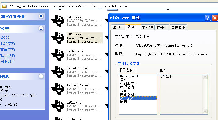

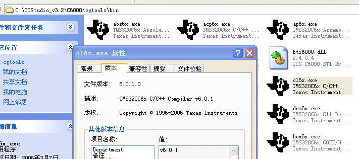

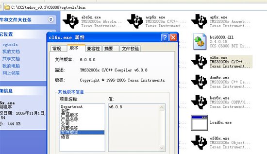

  • What version of the C6000 compiler are you using in each of these three cases?  (The compiler version is not the same as the CCS version.)
  • The c compiler version is more and more new.
    ccs3.2<============> cl6x.exe 6.01
    ccs3.3<============> cl6x.exe 6.08
    ccs5.0<============> cl6x.exe 7.21

  • I did some testing with CCS 5.2.1 (latest version) and different versions of the compiler tools and profiled the functions in each case. I found that the cycle counts for the jisuanDiv routine was very high for the 7.2.1 cgtools as you noted, however they were back down with version 7.3.4 which is the version included with CCS 5.2.1.
    I used your C source code and linker command file and simply rebuilt the code with different versions of the compiler tools in CCS 5.2.1. I then ran the code on a C64x+ CPU Cycle Accurate simulator.
    Here are the values I saw with the different versions of cgtools:
    CGT 6.0.8:
    jisuanAdd - 156
    jisuanDiv - 294
    jisuanMul - 125
    CGT 7.2.1:
    jisuanAdd - 154
    jisuanDiv - 899
    jisuanMul - 131
    CGT 7.3.4:
    jisuanAdd - 154
    jisuanDiv - 393
    jisuanMul - 131
    There was probably an inefficiency in the divide routine in the runtime library of CGT 7.2.1 that caused the spike in cycle count for that version.
