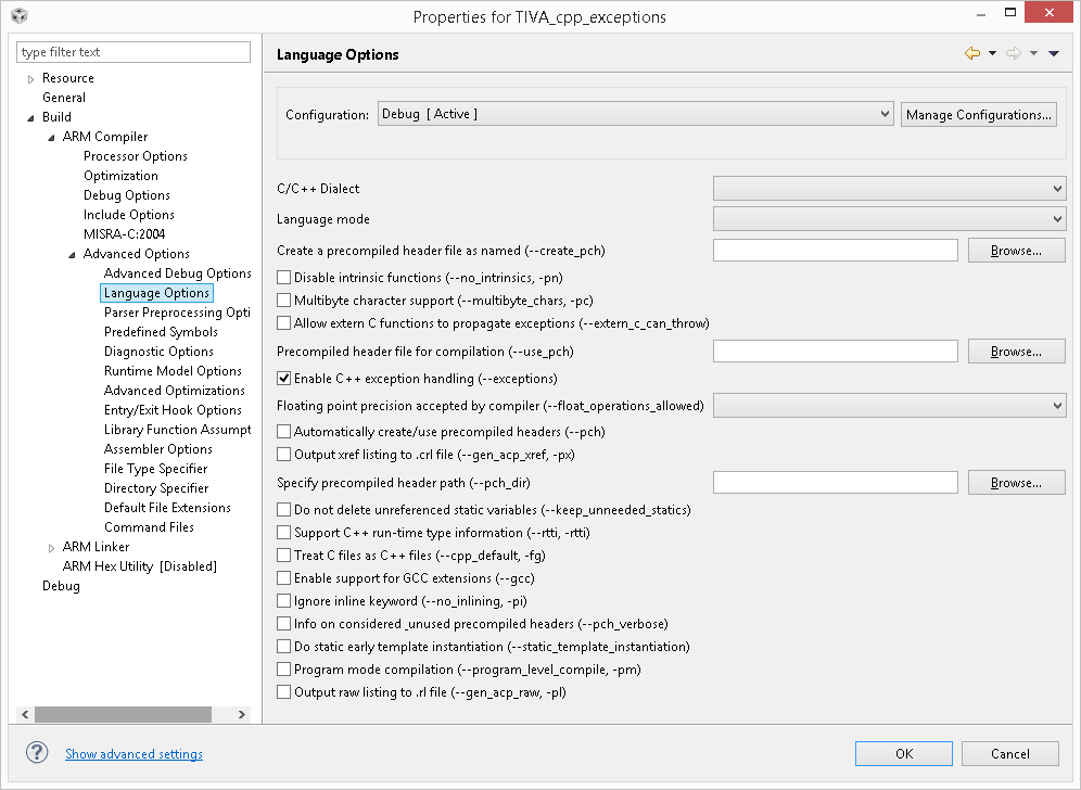

  • hi Archaeologist,
    I met the same problem. my target processor F28M35, and the compiler is arm_5.0.1. But i can't find the exception enabled version run-time support library in the compiler directory.
    there is only two lib file.  rtsv7M3_T_le_eabi.librtsv7M3_T_le_xo_eabi.lib
    Could you help me on this ?
    When the ARM compiler is installed only some of runtime support libraries are present.
    CCS will build other versions of the runtime support library as required.
    E.g. set the Runtime support library to <automatic>
    Under language options select "Enable C++ exception handling":
    When the project using C++ is compiled the exception handling version of the runtime support library will be built it it doesn't already exist:
    'Building target: TIVA_cpp_exceptions.out'
    'Invoking: ARM Linker'
    "C:/ti_ccs6_0/ccsv6/tools/compiler/arm_5.0.8/bin/armcl" -mv7M4 --code_state=16 --float_support=FPv4SPD16 --abi=eabi -me -g --diag_warning=225 --display_error_number --diag_wrap=off -z --stack_size=512 -m"TIVA_cpp_exceptions.map" --heap_size=0 -i"C:/ti_ccs6_0/ccsv6/tools/compiler/arm_5.0.8/lib" -i"C:/ti_ccs6_0/ccsv6/tools/compiler/arm_5.0.8/include" --reread_libs --warn_sections --display_error_number --diag_wrap=off --xml_link_info="TIVA_cpp_exceptions_linkInfo.xml" --rom_model -o "TIVA_cpp_exceptions.out" "./tm4c129encpdt_startup_ccs.obj" "./main.obj" "../tm4c129encpdt.cmd" -l"libc.a"
    <Linking>
    warning #10366-D: automatic library build: using library "C:\ti_ccs6_0\ccsv6\tools\compiler\arm_5.0.8\lib\rtsv7M4_T_le_v4SPD16_eabi_eh.lib" for the first time, so it must be built. This may take a few minutes.
  • Thanks.... it works when i use the <automatic> lib
