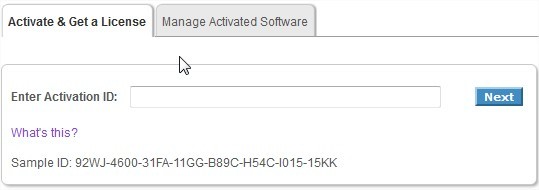

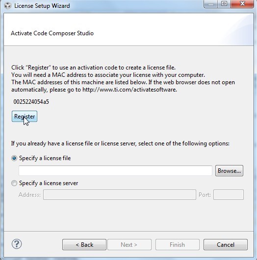

I try to Activate CCS :
but the procedure ask me Activation ID, and I do not have that.
So is it a licence problem ? and if yes how can get an unlimited licence ?
