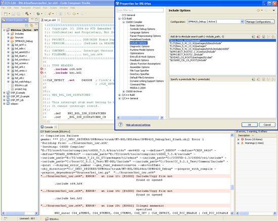

    I'm using Code Composer v5.2.1. I've imported a legacy CCS 3.3 project for a C64xx DSP that uses DSP/BIOS. In the project is an assembly file (a .s64 file). This assembly file uses '.include' to bring in c64.h64 and hwi.h62. I've found the correct locations for those files in the Code Composer installation (specifically E:\TI\bios_5_41_13_42\packages\ti\bios\include). I've added this path in Build Settings->Build->C6000 Compiler->Include Options. However, when I build I get a mangled error message:
ERROR! at line 13: [E1000]
Include/Copy file not
                                                  found
or opened
                 .include c64.h64
    When I look at the command line and it's parameters I notice that not all of the include paths are there, specifically not the path where the file to be included is located.
    Could you send me a screen shot of the Include Options in the build properties and also the build output window when the asm file is assembled?

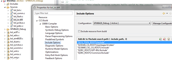

  • Hi Ki,
    Here's a screenshot for you:
    Josh

  • Hi Josh,
    The issue (according to the test case you gave me) is that the files in the 'Sources' subdirectory (including bsl_isr.s64) all have file specific options which override the project level properties.
    If I look at the file specific options for bsl_isr.s64, it does not have the path to the bios include directory that is in the project level options:
    Note the little "key" option that specifies that has file specific options.
    You will need to add the bios include folder to the file specific options.
    ki
