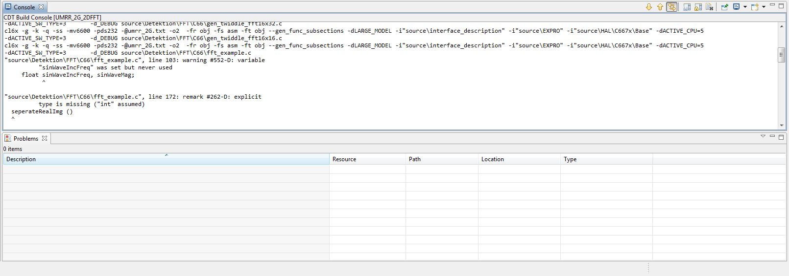

  • In the CCS v5.3.0.00083 (downloaded on Nov, 20th, currently not available any more) the parser shows nothing in the Problems view.

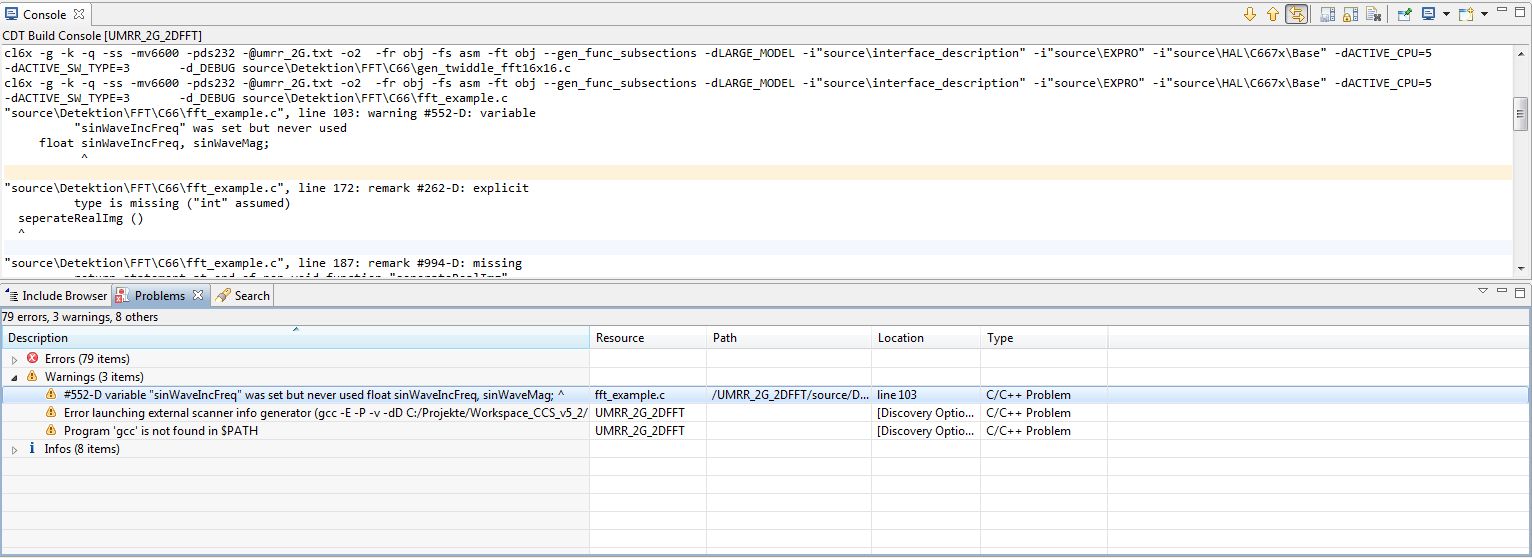

  • Hi Lisa,
    thanks for your reply.
    Today I have installed the newest CCS version 5.3.0.00090: the behaviour is the same as for the v5.3.0.00083, i.e., the TI error parser seems not to work. I deleted the metadata but it did not change the behavior. The original project files (.project and .cdtproject) were created for CCS 5.2.0.
    I also added an own error parser to the CCS in order to compare it with the TI error parser.
    Now the screenshots:
    The attached file CCS_520_TI_ErrorParser.jpg contains the Console and the Problems view in CCS 5.2.0 (screenshot done on a different PC with Windows 7 Professional 32 bit, but the behavior was the same on the 64 bit PC): The TI C/C++ Error Parser works as expected (see e.g. the warning #552 in fft_example.c it is in the Console and the Problems view).
    The second and third attachment will be added to the next posts since there is only one attachment per post allowed.
    Arkadius
  • The second attachment CCS_530_TI_ErrorParser.jpg contains the screen shot of the Console and Problems view using the TI C/C++ Error Parser with CCS 5.3.0.00090: the warning is still in the Console view but it is not parsed correctly by the TI error parser, i.e there is no warning (or Info) in the Problems view.
  • The attachment CCS_530_user-defined_ErrorParser.jpg shows the Console and Problems view when using an own user-defined error parser with CCS 5.3.0.00090: this seems at least to find the warning (see again warning #552) and the infos but in the description of the warning in the Problems view is only the first line contained because the user-defined error parser seems to work only line by line and cannot have an error/warning/info description that spans multiple lines. Unfortunately the TI compiler always wraps the error/warning/info messages in the Console. If you compare this with the description produced by the TI error parser on CCS 5.2.0, you can see that the TI error parser has the whole warning description (corresponding to multiple lines in the Console) in the Problems view. It would be nice to have the TI error parser that was working with CCS 5.2.0 also working with CCS 5.3.0.

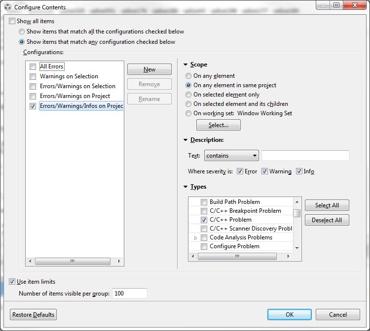

    It should be noted that I have only activated "C/C++ Problem" type in the "Configure Contents" settings of the Problems view in order to illustrate the "TI C/C++ Error Parser" problems. Other types (like "Semantic Error") are (in my opinion) not influenced by the "TI C/C++ Error Parser" (see the attached file CCS_Problems_view_configuration.jpg).
