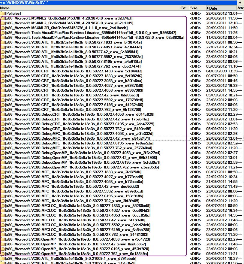

After installing TI Code Composer on my computer (it happens on XP 32-bit and also Win7-64bit), I can't seem to compile dlls and distribute to customers.
I tried uninstalling and reinstalling VS 2005 (including Service Pack), but to no avail.
The dll works on the computer that has the Visual Studio C++ 2005 environment. It can be loaded and the application runs well.
On another computer, though, the dll cannot be loaded:
hDll = LoadLibrary(TEXT("MyProgram.dll"));
This line fails to load. hDll returns with NULL.
If I compile another project which yields MyProgram.ax - it cannot be registered on another computer (regsvr32.exe).
As I mentioned, the same exact source code, when compiled on a computer without the TI CodeComposer environment can be compiled (dll and ax) and also distributed to customers.
Please tell me how to fix this.

  • Hi -
    I'll try uninstalling TI Composer and see if it makes a difference. I'll also try installing the Service Pack for VisualStudio 2005.
    It probably has something to do with the run-time of VC80 on the customer's machine. But why was there a change because of the TI CCS?
    Here is a screen shot of the WinSxS folder - and you can see the many versions of VC80 installed on my computer.
    Mechi

  • Mechi,
    One explanation for this problem is as follows: VS2005 installs version "A" of the Microsoft redistributable libraries. When you install CCS, it installs version "B" (which is newer than version "A").  Now, when you compile a program with VS2005, VS uses the most recent version of the various installed redistributable libraries so you end up with a dependency on version "B".
    You can confirm what the dependencies are by using the Dependency Walker tool that comes with VS2005.
    You could solve this problem by installing the later Microsoft redistributable package on the PCs you want to run your binaries on. The installer can be downloaded from Microsoft, or you can grab the executable included with CCS. The CCS one is located at: <zip file extraction dir>/baserepo/vcredist_x86_2005.exe .
    You can also solve this problem by statically linking the RTS libs with your binary or by putting the dependent DLLs in the same folder as your application. There are probably other ways to solve this too. One Google reference you might find useful: here .
