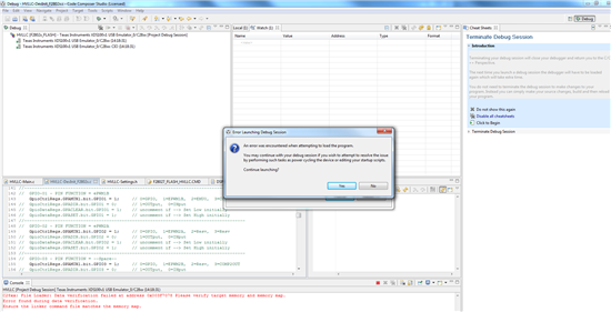

I attach some screenshots just in case:
When I hit debug-button, connecting to the target goes OK. But when flashing begins, an error appears to console:
When I click "Yes", debug process ends:

    Just to inform, screenshots in my first post are snapped from situation, where CCS4 was used. With CCS5 error is common flashing error instead of data verification error. Error prints in console are something like this:
    C28xx: Flash Programmer: Error encountered when writing to flash memory
    C28xx: Trouble Writing Memory Block at 0x3f6000 on Page 0 of Length 0xae
    Cannot write to target
    I noticed, that problem is not tied to one exact memory block. Sometimes it is in 0x3f6000 and sometimes it is somewhere else, for example in 0x3f7078. So this is not 100% repeatable. I have read this forum quite a lot during last few weeks. Flashing errors like this are quite common and usually they are solved by changing version of CCS. Can you please give me some other tips also? What are the most common reasons for problems like this? I would really appreciate some kind of "checklist".

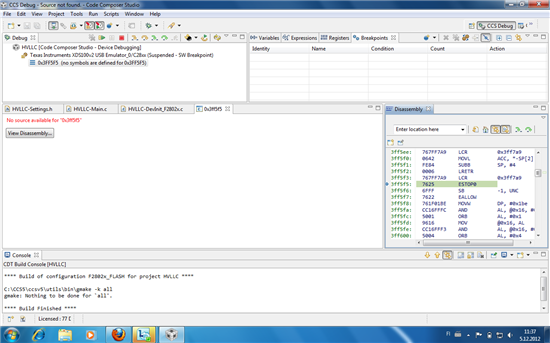

    I installed 5.3 today. There is no flashing errors in console anymore, so I guess that this is a little step ahead. Still there is something wrong, because I'm not able to run the code. I tried with many examples and after flashing and hitting run-button debug view looks like screen below:
    Why debug process is suspended due to breakpoint? I have not placed any breakpoints in code. I discovered similar behaving with 5.2 also.

  • Hi Juha,
    what steps have you taken to get to the above state (from your latest screen shot)?  What example?  Did you import an unmodified example for your exact board/part?
    What happens if you hit run again?  Ie go past the breakpoint.

  • Lisa,
    After project is imported, I build it by clicking project name in resource explorer and selecting "rebuild project". Then I hit debug-button from toolbar. After this I'm in situation where I took my last screenshot. I've tried to flash F28027 ControlStick projects from controlsuite. Examples were not modified before attempting to flash. I should be able to flash and run F28027 ControlStick examples, right?

  • Hi Juha,
    This message is typically seen when the debugger is launched but no code has been loaded to the target. So if you selected the target configuration file (.ccxml) and launched the debugger, but have not yet loaded a program to target, then this message is to be expected. However, some setting or something might be stopping you short of a load for your case as well.  Can you confirm you use the debug button and do not simply launch a target configuration?  You should be able to go to menu Run->Load->Load Program and browse to the program you want to load. Once the program is loaded, the source will be visible.  Can you give this a try?  What makes you think you "can't run the code" ?

  • Lisa,
    These are the steps I'm taking. It doesn't matter am I using debug-button or launch selected configuration->connect to target->load program-> etc.. Behaviour is same with both approaches. Please see screens below:
    When I'm loading program to target "no source available" window appears. There is no error messages in console.
    After this debug-window tells that code is running. Source is not visible.
    When I hit "suspend", "no source available" window appears again. I can't search source manually, only "view disassembly" button is present.
    So what is really happening? How is possible that code is running if there is no source at all? If source is not defined automatically, is there a way to do it manually?

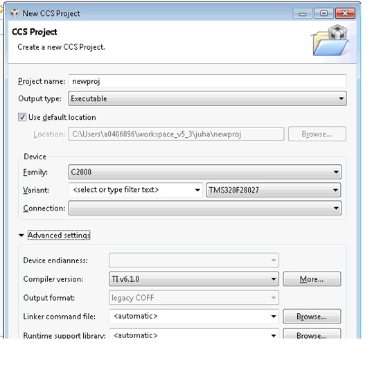

  • Hi Juha,
    thanks for doing that test.   Would you now go back to the project you would like to work and do the following.  Have a look at project->properties->general.   Have a look whether the linker command file and runtime support library indicated there are for flash or for RAM and are appropriate.  You could even also attached the screenshot here.  Try checking those setttings to get that example up and running.

  • Hi Juha,
    it seems you are using a specific linker command file.  Is this for a reason?   I suspect this might be the issue.  What if you select automatic or the built in one for the device as shown in the screen captures below?

  • Lisa,
    my project contains two linker command files: "F28027_FLASH_HVLLC" is for flash memory allocations and "F2802x_Headers_nonBIOS" is for locating peripheral register data sections to proper memory location. Both files are from example project and files should be ok. Files are in attached zip-package.
    How should I act when I have two linker command files? Both files are sent to linker, you can see that from console prints. Post-build console prints are also in zip-package. Does it matter in which order linker command files are sent to linker and how can I change order of linker command files?
    map-file is also in zip package. I don't see anything bizarre in map-file, memory configuration and sections are ok. If you check section allocation map, only FLASH_A is used. If map-file contains correct information, linker command files should be ok too, right?
