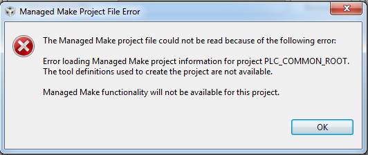

  • Lisa,
    I'm having the same problem, for the most part. I am running the PLC example software and PLC drivers on the C28. I have had numerous problems when I moved to my Win7 machine. CCS 4 was running OK for awhile when it suddenly failed to compile my C28 code, saying that it couldn't locate the platform.tci file, which appeared to be bogus.
    So I tried to upgrade BIOS and  XDCtools, etc. to no avail. So, I determined that my only option was to reload 4.2.4 and then upgrade to 4.2.5.0005. 4.2.4 loaded fine, but when I tried to run my program, it appeared that it needed something from 4.2.5. So I tried to upgrade by executing the downloaded 425 executable ( no "setup_CCS_4.2.5.xxxxxx.exe " as indicated in the Release Notes. I was instructed that I could not load this program into my V4.2.4 folder and must create a new one, which I did. Running this version and trying to load my app, I am told that Managed Make information is not available.
    From the information, it appears that I must be able to overlay this patch onto V4.2.4 but cannot. I did not have this problem on my XP machine as I have been running 4.2.5 successfully for a long time.
     I have also been instructed not to run the PLC firmware on CCS V5. I have previously tried to run PLC C28 code with V5 on Win7 and have never been able to get my problems resolved. I have received no responses from emailing the PLC guys.
    There appears to be a number of complications. Please help me get this sorted out.
    Pat

  • Hi Christian
    I have the same problem. I can not open PRIME PLC example with both CCS4 v4.2.5.0000 and CCS5 V5.3.0.00090. When I import ti_plc_prime_llc_example example it reports that the managed make project file is missing. When importing with CCS5 v5.3 it reports the meta-data cannot be interpreted.
    Can you tell me how to solve the problem?
    Thank you very much.
  • Hi Bin Rua,
    Unfortunately no. TI never came up with a solution for my part. I had some contact with their PLC support line per e-mail, but they failed to figure this out. Several others have the same issues, so it looks to me like their PLC solution is a bit immature at the moment. Although, older versions of the PLC framework seems to be working, but something is wrong with their updated ones. I don't know where you could get a working older version.
    Good luck either way, and please report back.
