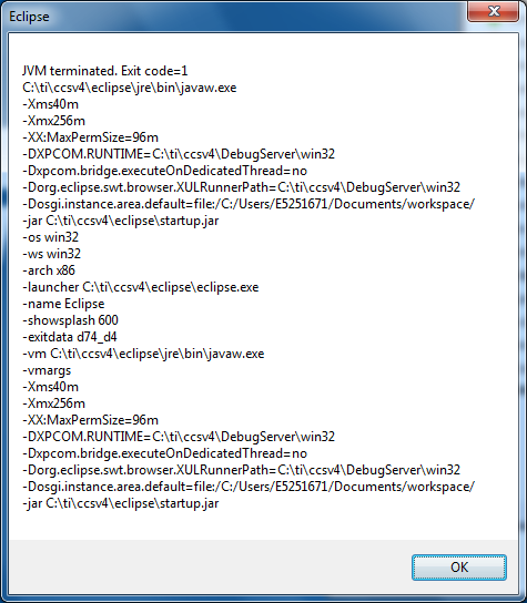

  • Thank You.But when iam using CC Studion 4.2.5 version in Windows7 64 Bit iam getting the below error while running some scripts.
    Any Inputs would be highly appreciated,Thank you inadvance.

  • Hi Sekhar,
    can you please explain what you mean by "when running scripts"?  What scripts and how are you running them?  Did you see any issues at installation?  Can you otherwise use CCS normally?  Ie are you able to create projects and debug normally when not "running scripts"?  Another thing that would help is if you turn error logging on and send us the logs.  This is described here
    http://processors.wiki.ti.com/index.php/Troubleshooting_CCS

    Please see below response to the questions:
    1.Can you please explain what you mean by "when running scripts"?
    Ans: When the RTRT tool invoke Code composer to execute the scripts.
    2.What scripts and how are you running them?
    • test files are instrumented by RTRT and compiled with the Code Composer Studio (CCS) Integrated Development Environment ver 4 compiler.
    • The test files are executed on the target environment.
    Did you see any issues at installation?  -No

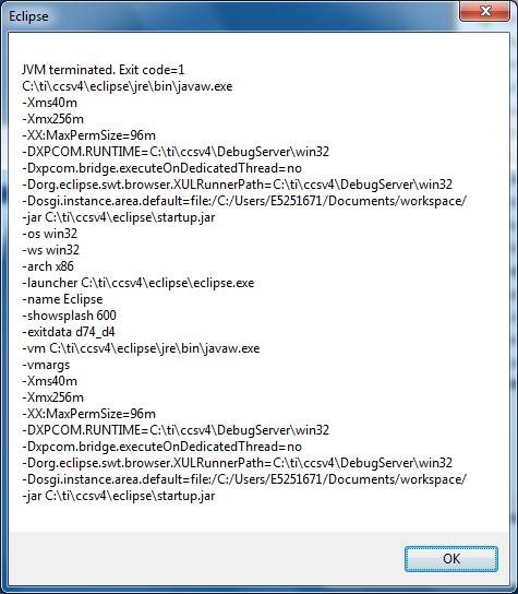

    Can you otherwise use CCS normally?  -No ,Giving following screenshot (Eclipse)after linking operation
    Are you able to create projects and debug normally when not "running scripts"?-No
    Another thing that would help is if you turn error logging on and send us the logs. –Attached (hs_err_pid6360.log)
    This is described here:_http://processors.wiki.ti.com/index.php/Troubleshooting_CCS

    VM Arguments:
    jvm_args: -Xms40m -Xmx256m -Dxpcom.bridge.executeOnDedicatedThread=no -Dorg.eclipse.swt.browser.XULRunnerPath=C:\ti\ccsv4\scripting\bin\..\..\DebugServer\win32 -DXPCOM.RUNTIME=C:\ti\ccsv4\scripting\bin\..\..\DebugServer\win32
    java_command: org.mozilla.javascript.tools.shell.Main ti_tdp.js ezDSPConfiguration.ccxml cc4_f28335/robust.out
    Launcher Type: SUN_STANDARD
    Environment Variables:
    JAVA_HOME=C:\ti\ccsv4\scripting\bin\..\..\DebugServer\..\eclipse\jre
    JRE_HOME=C:\Program Files (x86)\IBM\RationalSDLC\Common\Java5.0\jre
    CLASSPATH=C:\Program Files (x86)\IBM\RationalSDLC\ClearQuest\cqjni.jar
    PATH=C:\ti\ccsv4\common\bin;C:\ti\ccsv4\common\uscif;C:\ti\ccsv4\DebugServer\slicense;C:\ti\ccsv4\scripting\bin\..\..\DebugServer\..\eclipse\jre\bin;C:\ti\ccsv4\scripting\bin\..\..\DebugServer\..\eclipse\plugins\com.ti.dvt.tidisassembly_1.0.0\os\win32;C:\ti\ccsv4\scripting\bin\..\..\DebugServer\..\eclipse\plugins\com.ti.dvt.ofssymbolmanager_1.0.0;C:\ti\ccsv4\tools\compiler\c2000\bin;C:/ti/xdctools_3_20_03_63;C:\Program Files (x86)\IBM\RationalSDLC\common;C:\Windows\system32;C:\Windows;C:\Windows\System32\Wbem;C:\Windows\System32\WindowsPowerShell\v1.0\;C:\Program Files (x86)\Common Files\Roxio Shared\DLLShared\;C:\Program Files (x86)\Common Files\Roxio Shared\10.0\DLLShared\;C:\Rational\TestRealTime\bin\intel\win32;C:\Rational\common;C:\GnuWin32\bin;C:\Texas~1\ccsv4\tools\compiler\c2000\bin;C:\MATLAB\R2009bSP1\bin;C:\Program Files (x86)\IBM\RationalSDLC\ClearCase\bin;C:\Program Files (x86)\IBM\gsk8\lib;C:\Program Files (x86)\IBM\gsk8\bin;C:/ti/xdctools_3_20_03_63
    USERNAME=E5251671
    OS=Windows_NT
    PROCESSOR_IDENTIFIER=Intel64 Family 6 Model 23 Stepping 10, GenuineIntel
    ---------------  S Y S T E M  ---------------
    OS: Windows NT 6.1 Build 7601 Service Pack 1
    CPU:total 8 (cores per cpu 4, threads per core 1) family 6 model 7 stepping 10, cmov, cx8, fxsr, mmx, sse, sse2
    Memory: 4k page, physical 4193656k(2437044k free), swap 4194303k(4194303k free)
    vm_info: Java HotSpot(TM) Client VM (1.5.0_14-b03) for windows-x86, built on Oct  5 2007 01:21:52 by "java_re" with MS VC++ 6.0
    Logfile attached
    # An unexpected error has been detected by HotSpot Virtual Machine:
    #  Internal Error (0xe06d7363), pid=6360, tid=3404
    # Java VM: Java HotSpot(TM) Client VM (1.5.0_14-b03 mixed mode)
    # Problematic frame:
    # C  [KERNELBASE.dll+0xb9bc]
    ---------------  T H R E A D  ---------------
    Current thread (0x0022a7e8):  JavaThread "main" [_thread_in_native, id=3404]
    siginfo: ExceptionCode=0xe06d7363, ExceptionInformation=0x19930520 0x000cdeac 0x1943a6f4
    USERNAME=E5251671
    OS=Windows_NT
  • Hi Sekhar,
    just to confirm that you are unable to launch Code Composer Studio?  Ie We just want to be sure if the problem is specific to scripting or in general to your CCS installation somehow.  When you launch CCS what do you experience?  Have you tried a fresh workspace?
    Lisa
  • Hello Lisa,
    Thanks,We are able to Install properly.CC studio software open correctly without having any issues.
    While using ths software we are getting error as explained earlier.
    Sekhar Sanapala
  • HI Sekhar,
    can you please confirm ... can you debug and do everything properly in CCS.  In other words, what we need to know is whether the problem is only when running the external scripts.
    This makes a difference in how we proceed to debug.
    Lisa
  • Hi Sekhar,
    just thought I would check for any updates/further information with your enquiry.
    Lisa
