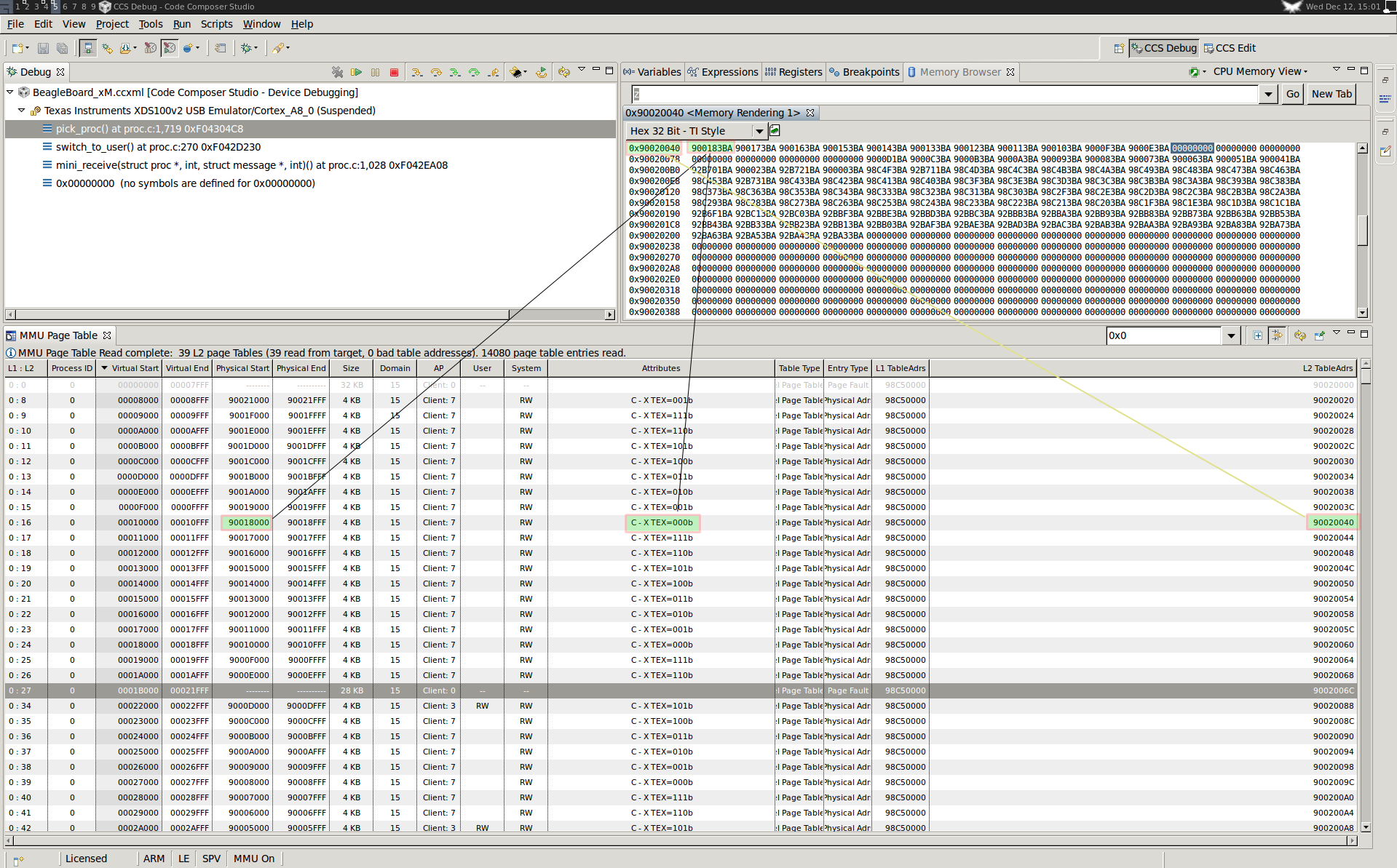

I have been trying to debug my application using code composer studio (Beagleboard XM/CCS : 5.2.0.00069 Linux/Opella XDS100V2)
The attribute colomn of the MMU Page Table view shows the caching properties of the memory(Bufferent/Cached/Executable/ and the TEX attributes).  When I compare the TEX attributes with what I write and what can be view in the physical memory view they look wrong.
In the attached example the value in memory is 0x900183BA and the value of TEX should be 110b. Also I see that the value of TEX is decremented every entry.
Is this a bug in CCS?
  • This is a level 2 entry (small page) and I expect TEX to be encoded in [8:6] while is looks like the code might be looking at the place where the level1 stores the TEX attributes[14:12].
  • Kees,
    This looks like a bug. I have filed a CQ to look into this SDSCM00046022.
    Also, we are currently in the process of revamping this feature. You may have observed that it is not scalable for a large number of page tables/entries and will not work for the newer extended (LPAE) page table format. The core functionality of the new implementation is available in CCS 5.3 via DSS API's.  The API's are accessible via the scripting console in CCS. The available page table visibility API's could be listed by typing 'help ptv' and then usage information regarding individual API's could be listed by typing 'help <api>' for example 'help ptvLookupAddress'. Please give this a shot; we would love your feedback.
    Mandeep
  • Kees,
    Good news. We were able to fix the original bug. It was an issue with an xml config file. You could try it out by replacing the existing file at <install root>\ccsv5\ccs_base\DebugServer\CacheInfo\TMS470RCXX.xml with the one attached or you can wait until the fix makes it into one of the CCS updates. Please back up the existing xml before overwriting it for the unlikely case you might have to undo the fix.

    					<!-- PTE Attribute String Decoders -->
    					<Decoder>
    						<DecoderName>GetCacheable</DecoderName>
    						<BitfieldMask>0x08</BitfieldMask>
    						<BitfieldShift>3</BitfieldShift>
    						<Multiplier>1.0</Multiplier>
    						<AddToProduct>0</AddToProduct>
    						<StringTable>
    							<NumStrings>2</NumStrings>
    							<Array index="0">-</Array>
    							<Array index="1">C</Array>
    						</StringTable>
    					</Decoder>
    					<!-- nG, APX -->
    					<Decoder>
    						<DecoderName>GetWriteBuffered</DecoderName>
    						<BitfieldMask>0x04</BitfieldMask>
    						<BitfieldShift>2</BitfieldShift>
    						<StringTable>
    							<Array index="1">B</Array>
    						</StringTable>
    					</Decoder>
    					<Decoder>
    					<!-- for L1 PTEs for both v5 and v7 MMUs, b9 defines the ECC Protection bit (P) -->
    						<DecoderName>GetL1ErrorCorrectionCtrl</DecoderName>
    						<BitfieldMask>0x0200</BitfieldMask>
    						<BitfieldShift>9</BitfieldShift>
    						<StringTable>
    							<Array index="1">P</Array>
    						</StringTable>
    					</Decoder>
    					<Decoder>
    					<!-- for ARM v7 MMU L1PTEs, if subpages are disabled, b17 defines the not Global bit (nG)-->
    						<DecoderName>GetL1NotGlobalMemoryBit</DecoderName>
    						<BitfieldMask>0x020000</BitfieldMask>
    						<BitfieldShift>17</BitfieldShift>
    						<StringTable>
    							<Array index="0">G</Array>
    							<Array index="1">-</Array>
    						</StringTable>
    					</Decoder>
    					<Decoder>
    					<!-- for ARM v7 MMU L2PTEs, if subpages are disabled, b17 defines the not Global bit (nG)-->
    						<DecoderName>GetL2NotGlobalMemoryBit</DecoderName>
    						<BitfieldMask>0x0800</BitfieldMask>
    						<BitfieldShift>11</BitfieldShift>
    						<StringTable>
    						</StringTable>
    					</Decoder>
    					<Decoder>
    					<!-- for ARM v7 MMU L1 PTEs, if subpages are disabled, b16 defines the shared memory bit (S)-->
    						<DecoderName>GetL1SharedMemoryBit</DecoderName>
    						<BitfieldMask>0x010000</BitfieldMask>
    						<BitfieldShift>16</BitfieldShift>
    						<StringTable>
    							<Array index="1">S</Array>
    						</StringTable>
    					</Decoder>
    					<Decoder>
    					<!-- for ARM v7 L2 PTEs, b10 defines the shared memory bit -->
    						<DecoderName>GetL2SharedMemoryBit</DecoderName>
    						<BitfieldMask>0x0400</BitfieldMask>
    						<BitfieldShift>10</BitfieldShift>
    						<StringTable>
    						</StringTable>
    					</Decoder>
    					<Decoder>
    					<!-- for L1 Page Table Entries, if IsArmV7MmuMode is true,
    					     AccessPermission bits are not used and the XN bit is set by b4 of the page
    					     table entry (only for 1MB and 16MB sections), not for coarse page table pointers
    					     or page faults -->
    						<DecoderName>GetL1ExecutableBit</DecoderName>
    						<BitfieldMask>0x010</BitfieldMask>
    						<BitfieldShift>4</BitfieldShift>
    						<StringTable>
    							<Array index="0">X</Array>
    						</StringTable>
    					</Decoder>
    					<Decoder>
    					<!-- for L2 Page Table Entries, if IsArmV7MmuMode is true,
    					     The XN bit is set by b15 of the page table entry for 64KB (Large) page table entries (specified by b1 = 0) and
    					     by b0 of 4KB (small) page table entries (specified by b1 = 1). -->
    						<DecoderName>GetL2ExecutableBit</DecoderName>
    						<BitfieldMask>0x02</BitfieldMask>
    						<BitfieldShift>1</BitfieldShift>
    						<DecoderTable>
    							<NumDecoders>2</NumDecoders>
    							<Array index="0">Getb15</Array>
    							<Array index="1">Getb0</Array>
    						</DecoderTable>
    						<StringTable>
    						</StringTable>
    					</Decoder>
    					<Decoder>
    					<!-- for ARM MMU v5 and v7, TEX fields are defined for L1 tables by bits b14-b12 if the 2 LSBs = 01 , else = 0 -->
    						<DecoderName>GetL1TypeExtensionBits</DecoderName>
    						<BitfieldMask>0x03</BitfieldMask>
    						<BitfieldShift>0</BitfieldShift>
    						<DecoderTable>
    							<NumDecoders>4</NumDecoders>
    							<Array index="0">AlwaysZero</Array>
    							<Array index="1">Getb14_b12</Array>
    							<Array index="2">AlwaysZero</Array>
    							<Array index="3">AlwaysZero</Array>
    						</DecoderTable>
    						<StringTable>
    							<NumStrings>8</NumStrings>
    							<Array index="0">TEX=000b</Array>
    							<Array index="1">TEX=001b</Array>
    							<Array index="2">TEX=010b</Array>
    							<Array index="3">TEX=011b</Array>
    							<Array index="4">TEX=100b</Array>
    							<Array index="5">TEX=101b</Array>
    							<Array index="6">TEX=110b</Array>
    							<Array index="7">TEX=111b</Array>
    						</StringTable>
    					</Decoder>
    					<Decoder>
    					<!-- for ARM MMU v7, TEX fields are defined for L2 page tables by bits b14-b12 if the 2 LSBs != 0, else TEX = 0
    					     if b1 = 1, TEX is in b8-6
    						 if b1 = 0, b1 = 1, TEX is in b14-12
    						<DecoderName>GetL2TypeExtensionBits_v7MMU</DecoderName>
    						<DecoderTable>
    							<Array index="2">Getb8_b6</Array>
    							<Array index="1">Getb8_b6</Array>
    						</DecoderTable>
    						<StringTable>
    						</StringTable>
    					</Decoder>
