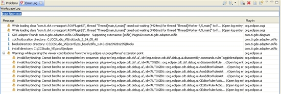

After updating the CCS V5.2 to V5.2.0.00090 I have the following problems:
a) On every file opening CCS displays an error message. Log shows:
java.lang.NoSuchMethodError: org.eclipse.cdt.internal.ui.editor.CEditor.getInputCElement()Lorg/eclipse/cdt/core/model/ICElement;

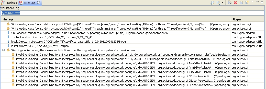

  • Hi Patrick,
    Just want to let you know what I have done so far. I did not uninstall the defect CCS. Instead I downloaded the new V5.3.0.00090 image (local installer) and installed this version over my defect installation. So far this was successfully. I could also run the update again (Check for updates) and CCS updated some of the Code Generation Tools. Also no more errors while opening "*.c" files.
    The error log still shows some warnings:
    This warnings are also showed in the CCS from my colleague. He has done a new clean installation.

    !MESSAGE invalid keybinding: Cannot bind to an incomplete key sequence: plug-in='org.eclipse.cdt.dsf.ui', id='org.eclipse.cdt.dsf.debug.ui.disassembly.commands.rulerToggleBreakpoint'
    !ENTRY com.ti.gde.adapter.c6flo 1 0 2012-12-21 09:42:42.749
    !MESSAGE install directory: C:\CCStudio_V5\ccsv5\eclipse
    !MESSAGE blocksDirectory directory: C:\CCStudio_V5\ccsv5\ccs_base\c6flo_1.0.0.201209281235\Blocks
    !ENTRY com.ti.gde.adapter.c6flo 1 0 2012-12-21 09:42:47.135
    !MESSAGE xdcToolLocation directory: C:/CCStudio_V5/xdctools_3_24_05_48
    !ENTRY com.ti.gde.diagram 1 0 2012-12-21 09:42:47.135
    !MESSAGE GDE adapter found: com.ti.gde.adapter.c6flo.C6floAdapter   Supporting extensions: [c6flo] PluginID=com.ti.gde.adapter.c6flo
    !ENTRY org.eclipse.osgi 2 0 2012-12-21 09:43:35.504
    !MESSAGE While loading class "com.ti.dvt.rovsupport.ROVPlugin$2", thread "Thread[main,6,main]" timed out waiting (4956ms) for thread "Thread[Worker-7,5,main]" to finish starting bundle "com.ti.dvt.rovsupport_3.3.0.201209281235 [769]". To avoid deadlock, thread "Thread[main,6,main]" is proceeding but "com.ti.dvt.rovsupport.ROVPlugin$2" may not be fully initialized.

    Patrick
  • Thanks for the update, I am glad that you got your CCS working. It is not recommend to over install a newer/older version of CCS into an existing install location, there are cache files that are leftover from eclipse that can affect your new install. I always uninstall or delete the existing install before installing a fresh copy into existing location.
    The warning that you saw shouldn't affects your working environment, unless it is an error.
    Patrick
