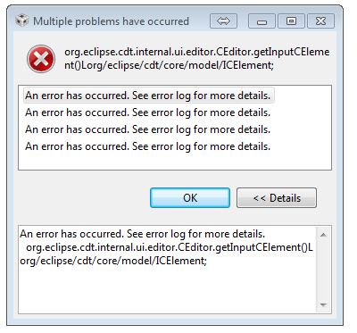

After updating my software yesterday from v5.2 to v5.3 and now whenever I open CCS I get the below error anytime I switch the file I am viewing.
When I view the error log the most recent error I am seeing are shown below:
!ENTRY org.eclipse.ui.workbench 4 2 2012-12-18 07:52:14.951
!MESSAGE Problems occurred when invoking code from plug-in: "org.eclipse.ui.workbench".

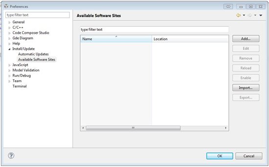

  • Hello Lisa,
    Below is the window view you have requested.
    What files would you like out of the installjammer directory?
    Jake
  • Hi Jake,
    odd that your available sites is blank.  There should be a ccsv5 folder if you would be able to send and zip that it would greatly help.
    Best REgards,
    Lisa
  • Hello Lisa,
    I am unaware of how those sites went blank.  Obviously I was able to update the software yesterday so they must not have been blank.
    Jake

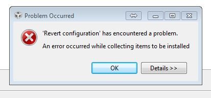

  • Hello Andy,
    Somehow the directory C:\ti was set to "Read Only" after changing that to be writable I thought I would revert back to my old installation but I got the errors shown below.
    Please let me know what actions should be taken.
    Jake
    An error occurred while collecting items to be installed
    session context was:(profile=epp.package.cpp, phase=org.eclipse.equinox.internal.p2.engine.phases.Collect, operand=, action=).
    No repository found containing: osgi.bundle,org.eclipse.equinox.p2.directorywatcher,1.0.300.v20110815-1419
    No repository found containing: osgi.bundle,org.eclipse.equinox.p2.extensionlocation,1.2.100.v20110815-1419

  • Jake,
    I wasn't clear why you wanted to revert your configuration? If you're still experiencing problems, I think the best course of action would be to delete your current install folder and re-install CCS using the same user that will be running CCS.
  • After re-installing the issue was resolved.
