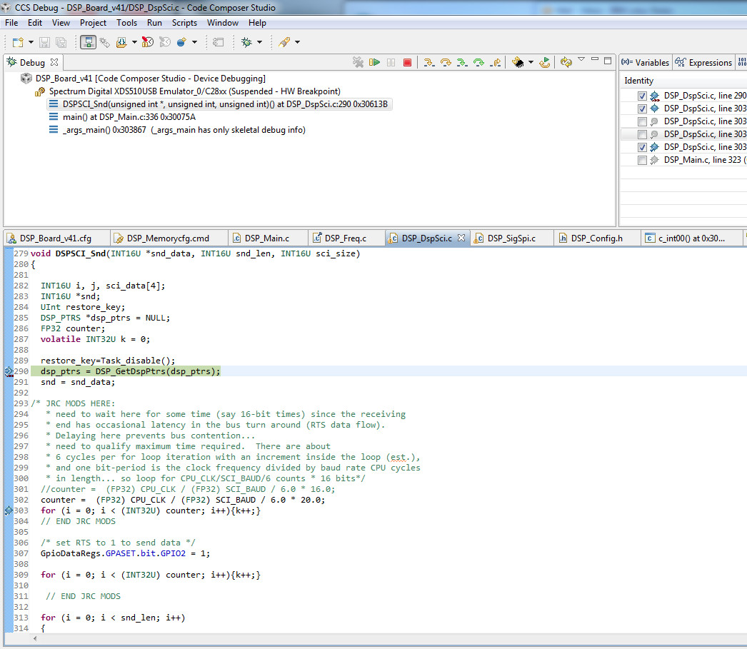

I was able to compete my update this project to current build environment.  Now my target is not working way it should.  I have stepped through my code and noticed that it has been skipping line of code during runtime and I'm unable to set breakpoint at some places.
For instance:
I am unable to set break points at line 293, it goes to line 294 and sets the break point there. It does this also for line 291.  However, I am able to set a break point at line 290.

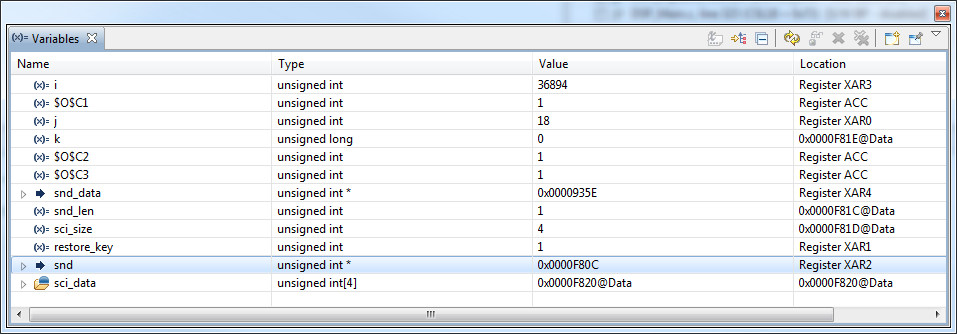

Also I have noticed that “counter” is  not listing in the Variables panel.
When I single step from line 290, it will skip to 294 and the variables that were skipped were not evaluated.
The Console panel had these error messages.
Console said:
C28xx: Trouble Setting Breakpoint with the Action "Remain Halted" at 0x30613e: Error 0x00000008/-1066 Error during: Break Point,  Cannot set/verify breakpoint at 0x0030613E
C28xx: Trouble Setting Breakpoint with the Action "Finish Auto Run" at 0x300504: Error 0x00000008/-1066 Error during: Break Point,  Cannot set/verify breakpoint at 0x00300504
