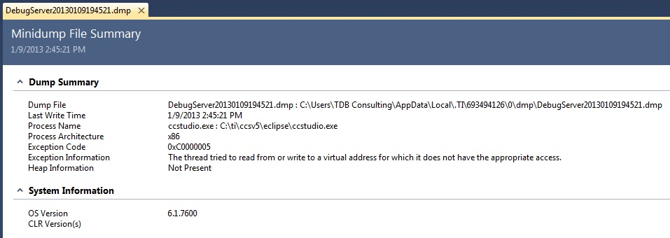

    About 1/3 of the time the Hello World program will crash, the other times the Debugger buttons go inactive till I terminate the program.
    I followed the instructions to enable error logging. The last few lines in that file are given below and the last line indicates: ERT E: A crash occurred
    0x0000129C 393743 4 POLL I: Yielding to other threads 0x0000129C 393743 4 TMS320F283XX_0 POLL I: TimeToPollAgain() target is idle and needs polling in 0 ms 0x0000129C 393743 3 TMS320F283XX_0 POLL C: Polling with state STATE_RUNNING and status EVENT_DSP_STEP_OVER 0x0000129C 393743 3 TMS320F283XX_0 GTI C: GTI_STAT_EX( 0x37B04F20, 0x3562F540 ) 0x00000544 393774 3 XPCOM C: ( (dsIBreakpoint*)3617F248 )->DescriptionBitfield( 3B70F7D8 ) 0x0000129C 394273 1 ERT E: A crash occurred - dump file written to "C:\Users\TDBCON~1\AppData\Local\.TI\693494126\0\dmp\DebugServer20130109194521.dmp"
    The contents of the "dump file" referred to above is shown below:

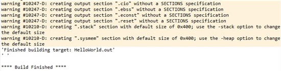

    The compiler gives several warnings about creating sections without a SECTIONS specification.
    Where do I set the "SECTIONS specification"?
    Thank you once again,
    Tim
    P.S. Incredibly, the text I attempted to paste on this page several seconds ago eventually appeared as shown below:
    warning #10247-D: creating output section ".cio" without a SECTIONS specification
    warning #10247-D: creating output section ".ebss" without a SECTIONS specification
    warning #10247-D: creating output section ".econst" without a SECTIONS specification
    warning #10247-D: creating output section ".reset" without a SECTIONS specification
  • Hi Tim,
    warnings can usually be ignored.  The SECTIONS are created in the linker command file (.cmd file) however I would make modifications with extreme caution.  This is usually automatically selected for you.

  • Hello Lisa:
    The image below is of the Dump File. (NoteTo insert an image, it is necessary to delete the "cookles" on the computer each time an image is inserted):
  • And, apparently, the image cannot be too large, otherwise, it will not display as in the previous eposode.
    Let's see if the image below will display...
  • Hi Tim,
    we need the actual .dmp file in order to investigate.  I will wait to continue on the offline portion of this thread for the file.
    Lisa

  • Hi Tim,
    Looks like both data and prog memory are being mapped to the same space due to invalid linker rules , and the application is writing into the program space and corrupting it.
    Basically , a valid linker command file is not being picked up during the creation of the executable.To pick it up , please do :
    1.Right click on the CCS project  and Add Files ,select the lnk.cmd file which will be under :
    tools\compiler\c2000_6.1.0\lib\
    2.clean and recompile
    With the executable created using the above steps, the issue that you observed seems to go away.
    Thanks!
    Simualtion Team.
  • Hello Texas Instruments Simulation Team:
    Thank you for the crucial information to get the Debugger for the CCS Simulator to work properly without crashing (or deactivating the debug buttons) when simply printing a number. I am surprised that the issue had not surfaced sooner.
    The file lnk.cmd actually resides in the directory <installation directory>\ccsv5\tools\compiler\c2000_6.1.0\lib\ and the "File Operation" used to "Add Files..." can be either "Copy files" or "Link to files". I prefer the "Copy files" option to have all files for the project in a single directory. That is apparently not possible when creating a Target Configuration for a Target (i.e. Emulator Connection and Device) for the CCS Simulator.
    Thank you all for all your time and efforts in this matter,
