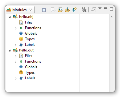

    Now I think I may have found something.  I use the modules view to see what symbol files I have loaded.  If I expand the functions for hello.obj and click on c_init0 it tries to open the disassembly window and this causes a crash!  So the disassembler seems to be crashing in trying to decode the memory or the debugger itself in reading the memory is crashing.  In my case I have no idea what is in that memory since I have only got symbols in the debugger and no program loaded to the target.  However it should not crash.  CCS is prompting me to send a crash log so hopefully we can figure out what is causing the crash.  I can consistently reproduce that.
    Since Peter is seeing this consistently I am going to see if having the dissassembly open at that address before loading will trigger the crash as well.
    Yes!  If I have the disassembly window open when I add the symbols CCS crashes when adding "hello.out".  I will file a defect and get someone to look at the crash log to see why we are getting the crash.
