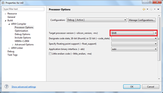

    In CCSv5.3 there is basic support for CortexM0 in CCSv5.3.  As far as M0 devices there are devices from the Analog group in TI that utilize M0 cores however from a general purpose Microcontroller standpoint we offer M3, M4 and R4 based devices and not M0.  There are also C2000 and MSP430 microcontrollers but if you are looking for an ARM based core then M3/M4/R4 is what we offer.
    The M0 support we have is the ability for the compiler to generate code for it.  If you create a new project in CCS choose Generic M3 as the device and then afterwards go into the project properties and change the processor revision to M0.
    There is also basic debug support for M0 cores via JTAG (not SWD at this time).
