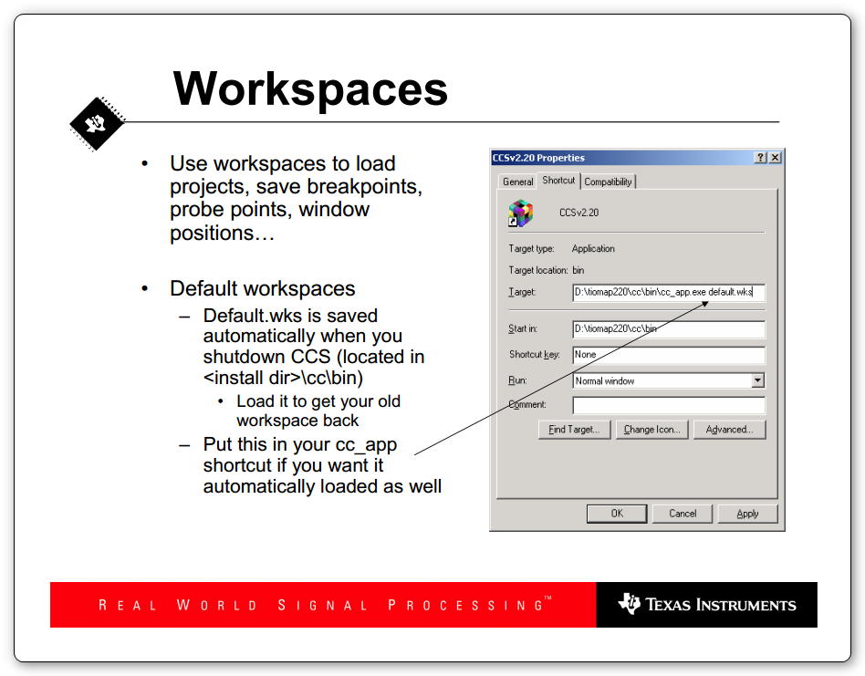

Mark,
The tips and tricks presentation for 3.3 available at this link covers that and a bunch of other useful hints: http://processors.wiki.ti.com/index.php/Tips_and_Tricks_for_CCStudio_IDE
