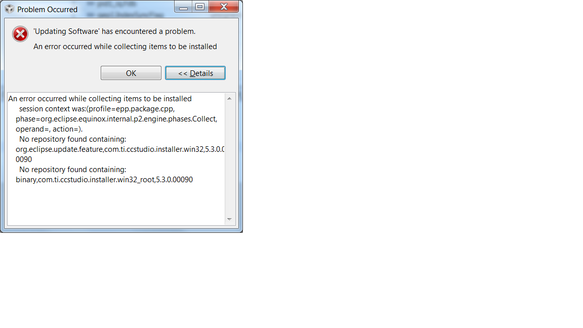

Hi
I am trying to update my CCSv5, I got the error shown in the following attached file.
Please, how do I proceed?
Vincent
  • Hi Vincent,
    were you looking for a specific update?  What updates were found?
    The best would be if we could possibly look at your log files from the installjammer registry directory (a possibly hidden folder in program files or program files(x86).
    Some tips are to check permissions and antivirus interference.
    Lisa

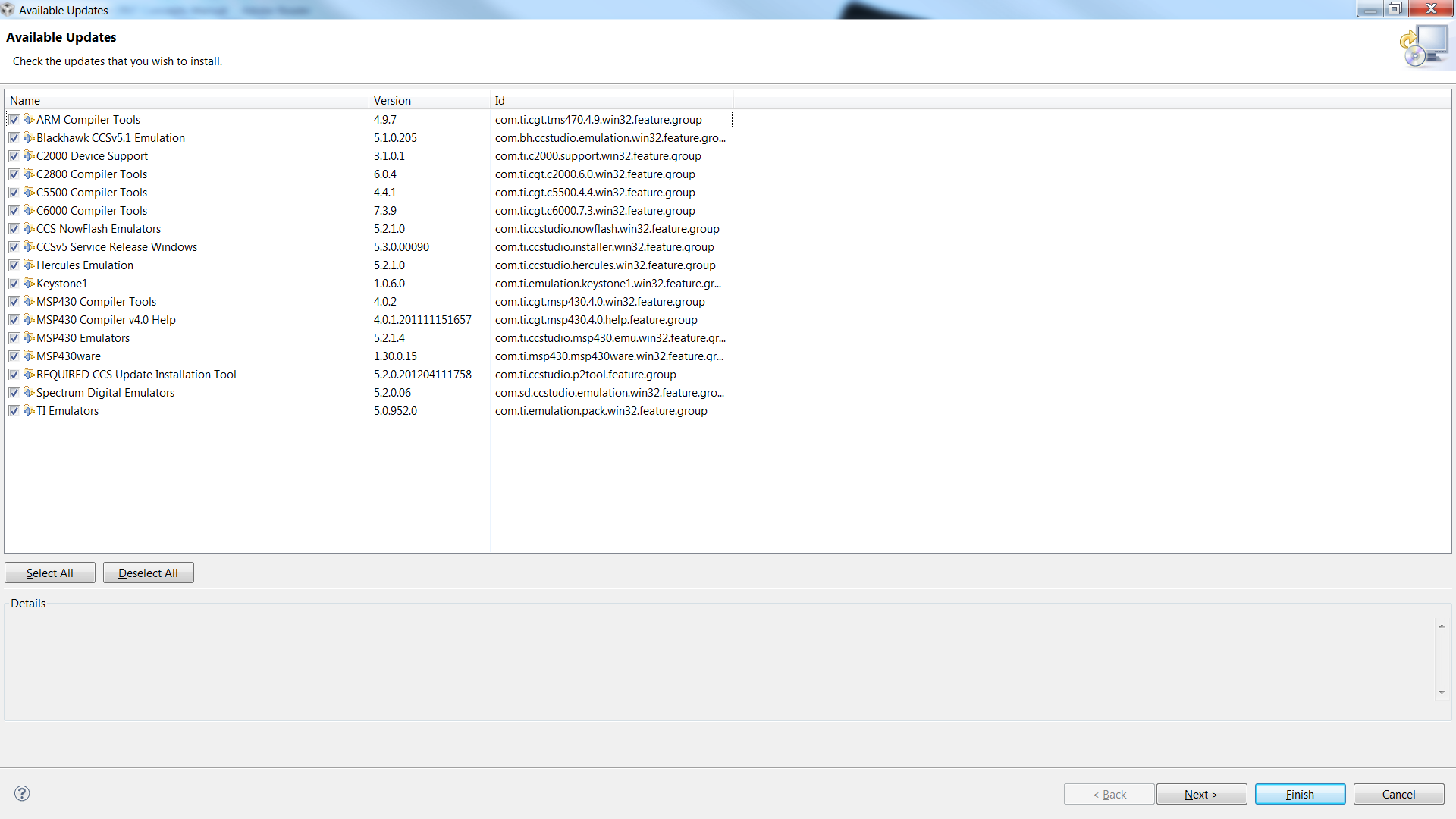

  • Hi Lisa,
    Thanks for your prompt response. I found the following installations ready when I tried again today.

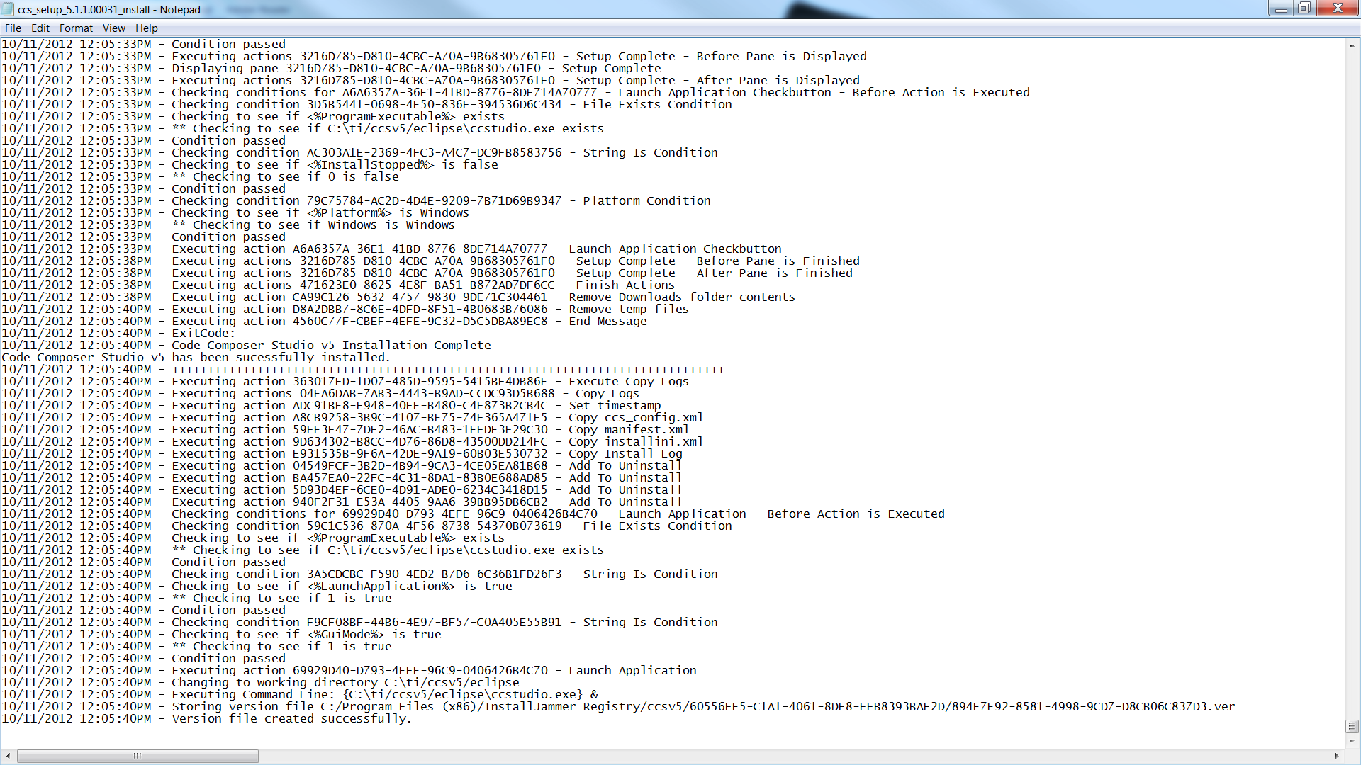

    My log file at the installjammer registry do not show my attempts to update. Here is a screenshot of the most recent
    log file. It was recorded when I installed CCS version 5.1.1.00031.
    Could it be that the files needed have been quarantined by my anti virus? My CCS seems to be working fine though.
    Thanks again
    Vincent
  • HI Vincent,
    thanks for the additional information.
    A couple things
    - yes, antivirus can interfere with installations
    - there were known issues with updates, especially if you are updating from 5.1
    I would recommend downloading and installing the latest version (5.3) into a new directory and keep us informed how that goes.
