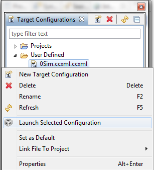

    What I do in CCS 5.1 is:
    File -> New -> Target Configuration File and check the "Use shared location" box (I use the default directory). When you do this, in the "Target Configurations" window (Window -> Show View -> Target Configurations) you will see it in the "User Defined" section, this way you launch your configuration and then load the .out of your project.
  • Another thing you can do is click on the Link file to project menu item in the capture above and this will add the file to your project as a linked file (reference).  This will allow you to have the same file in multiple projects.  However if you don't want to change the project to have this reference then what Johannes suggested is the way to go.
  • Yes, using the link makes the file available without copying to the project directory. This is essential to allow to define the target connection at one location
    Johannes proposal did not add the ccxml file to the project neither with nor without the shared location box. This caused the CCS to use the first USB connection to the wrong target and to erase the memory there. That's sad. I had to add the file as you wrote.
  • Yes, the way I said you won't have a copy or a link of the target file in all of your projects, but will allow you to load .out files without having the project in your workspace and will avoid problems of choosing the default target file if you have more than one ccxml in your project. Except for this, a shared target file works as usual, launch target, connect, load gel...
