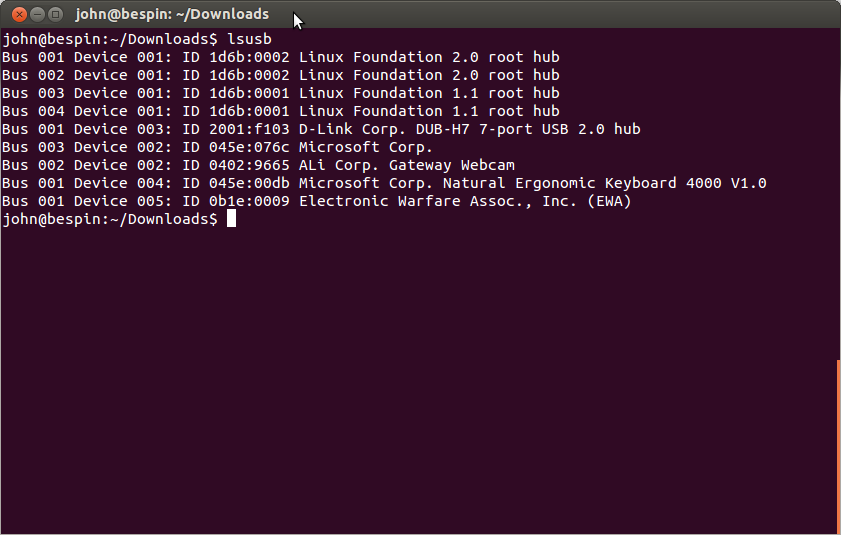

  • What do you see when you run lsusb?  There should be an item listed for "Electronic Warfare Assoc."

    Also, wrt your earlier post, I also get the usb ID 0b1e:0009 when I connect my XDS560 mez .

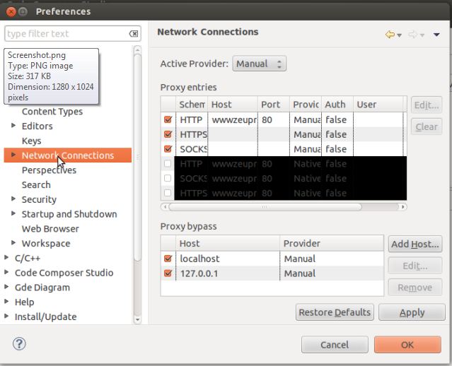

  • Ok, I have the explanation : I had actually another issue with the update manager which proceeded with rolling over the listed sites but actually downloaded nothing. First I enabled the ErrorLog window to see every log for the tool, then saw that I got messages about malformed packects from SOCKS ans HTTPS.... I then verified my Preferences settings for the Network Connections and observed that during the installation the CCS captured the proxy entries form my system settings, and that the "Active Provider" was turned to "Native". Those settings do appear in Dark Shadow in the Proxy entry list. I then changed the Active Provider to Manual and only stuffed the HTTP proxy with my proxy host, leaving the HTTPS and SOCKS empty, see picture below.
    From that stage I was able to correctly download the BlackHawk updates from the web repository and proceed the same way as listed by you earlier in this msg thread.
    Now I have full access to my XDS560Mezz .
