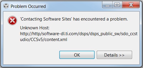

  • Hi.
    I desperately need to upgrade to CCS v5.3, But I currently have the same issue with a freshly installed CCS v5.2.1.00018. Here is a screen capture of the error:
    It seems to be a script error since 'http://' is entered two times above. I believe there is an xml file somewhere that I can edit to fix this?

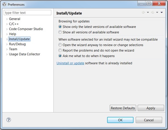

    Also:
    The Window->Preferences->Install/Update does not contain a List of Available Sites link. See screen capture below:
    So, Where exactly do I disable/edit those sites?

  • Sorry, here is the second screen capture from above:
    Estian
  • Hi Estian,
    two things here
    -> I would very very very strongly recommend just doing a fresh installation.  It will be worth the time (which will be almost the same)
    -> If you click on the little arrow to the left of Install/Update .... this is where you will be able to expand to see the list of available sites
