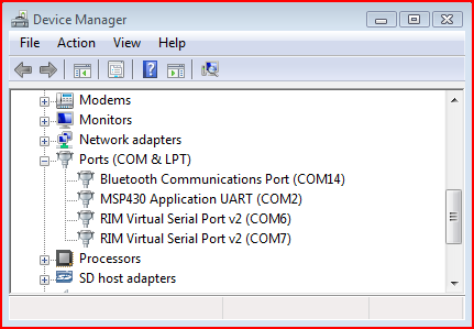

    - what do you see in the device manager?

    The device driver is USB -  I have tried all com ports from 1 thru 22 (to see if another process is interferring)
    The Hardware IDs:
    USB\VID_0451&PID_F432&REV_0100&MI_00
    USB\VID_0451&PID_F432&MI_00

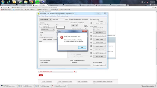

    Elprotonics FET- PRO430 Lite

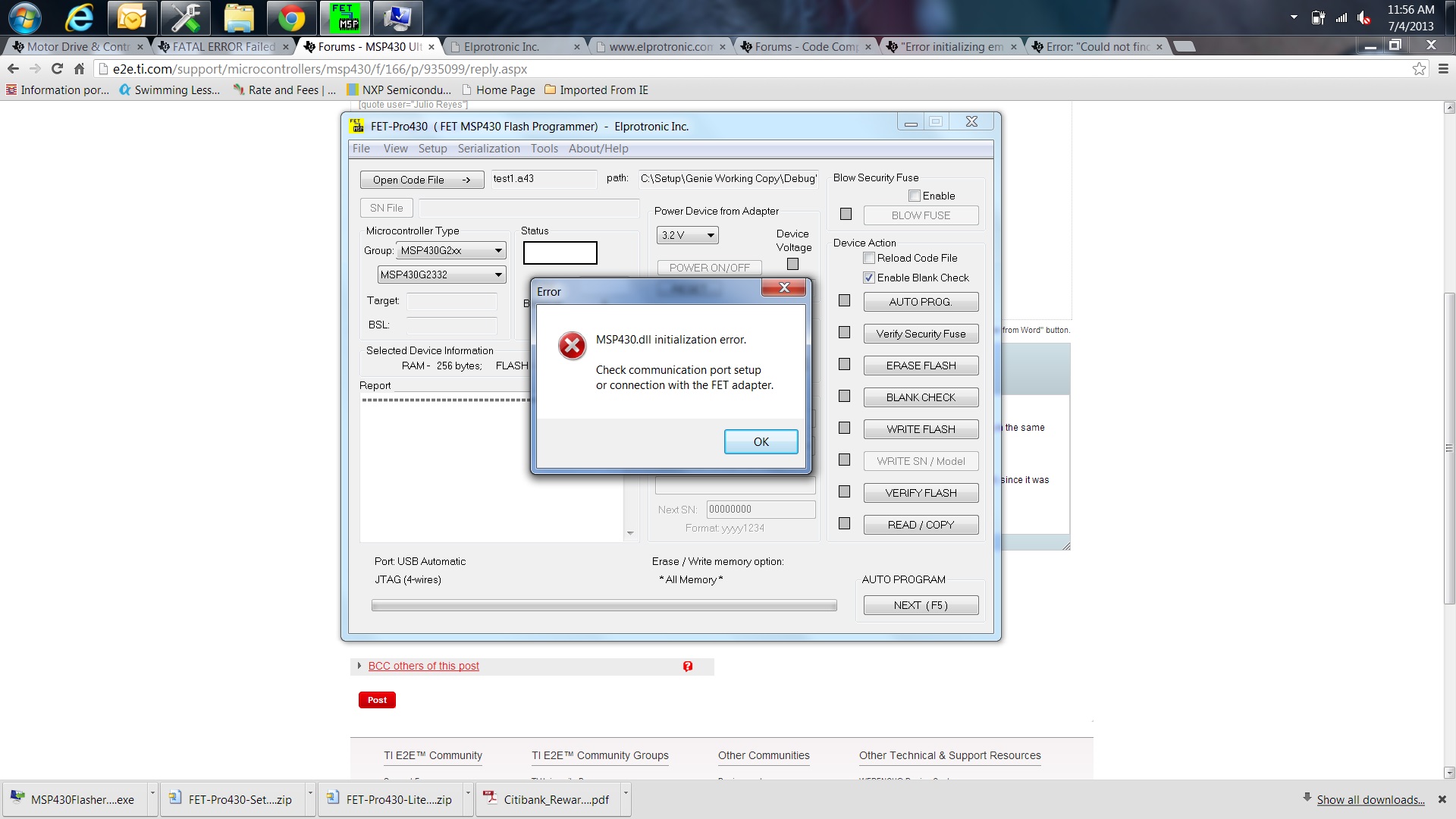

    When I try to READ/COPY I get this:
    I tried 3 cables, 7 usb ports and get identical results with 2 different computers, vista-32 and win8 pro-64
    Any ideas?  TIA

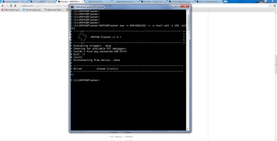

    I tried different (substituting) msp430.dll versions with no success. this is what i get every time using the  flasher program
    I think the board may be bad. nothing seems to work.

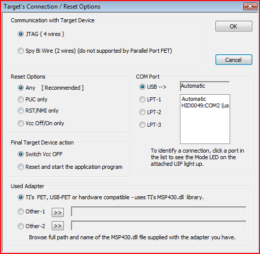

  • Lisa,
    I forgot to add that I did try to specify the spy bi wires in FET-Pro430 (2 wire)  and  mps430flasher.exe ( 2 wire and 4 wire) and got no change.
    Bill

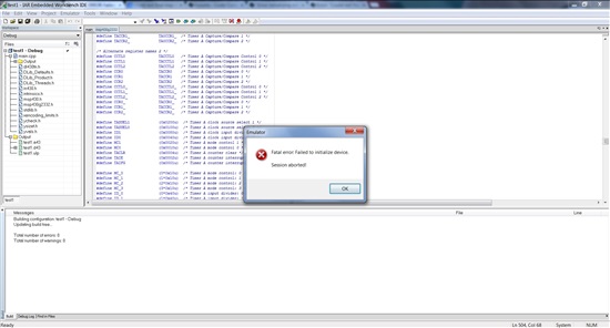

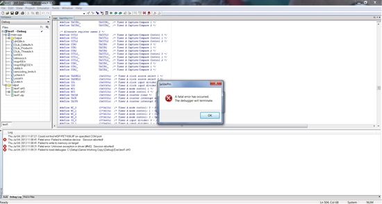

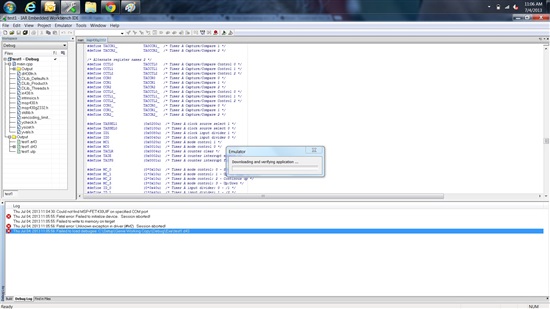

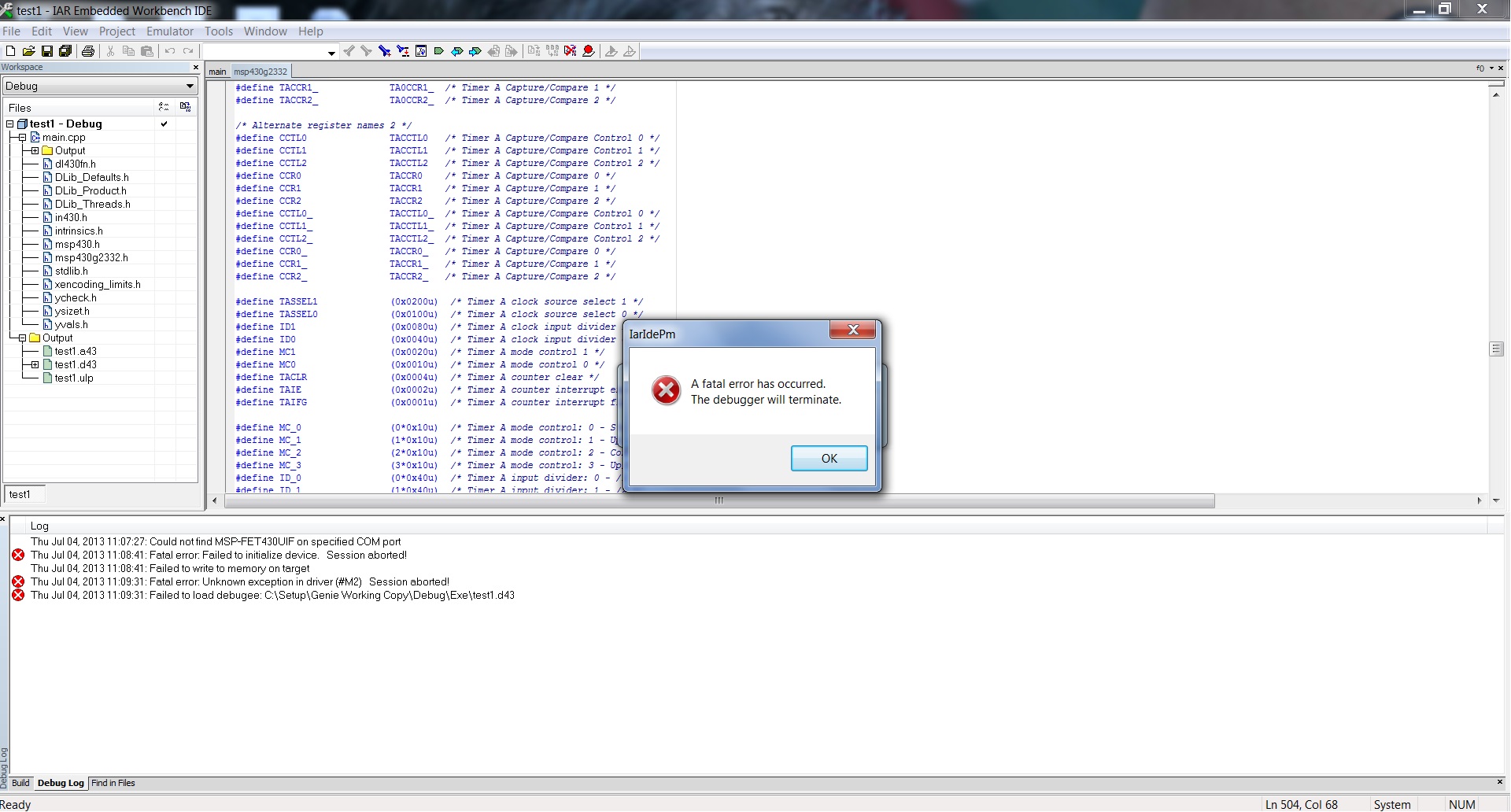

    I'm facing a similar Problem as Bill is facing.. From the day one when i started using the Launch pad it was happening, but until now at least i could able to download my program at some instant or the other by removing and and reconnecting the USB in one port or the other of the laptop. Two days before i got completely locked out by the emulator, it couldn't able to succeed in downlaoding the program not even a single time.
    I don't have a hardware debugger. Its just with Launchpad and the USB cable connected with it. I'm using IAR workbench 5.50. It results in error of Failed to initialize device.
    Then when i see in the log it shows as "COULD NOT FIND MSP-FET430UIF" on the specified COM Port.
    Below is the images which i have attached in sequence after when i click download and debug.
    In the below image you shall see the Error message in the Debug Log as "COULD NOT FIND MSP-FET 430 UIF in the selected com port"
    After this, the Emulator screen hangs as such, until i restart the application.
    Kindly let me know what i can do to solve this out.

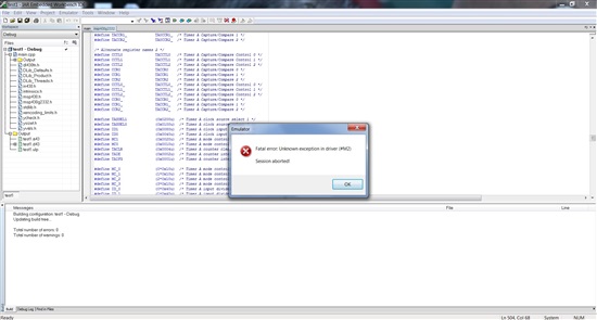

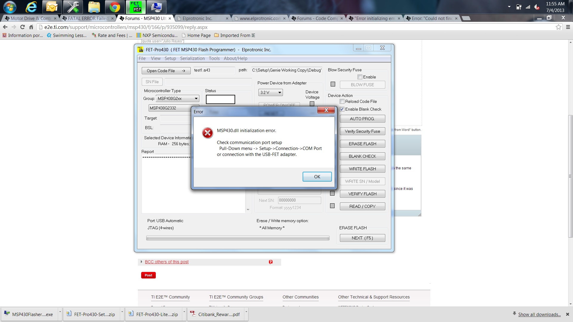

    I'm using IAR, I have never tried with CCS. May be i can try that either. I have some updations with the previous mail, i can post that image below. Which might give a clear picture of my problem.I tried with Elprotronic, it also resulted the same. I also tried with MSP430Flasher software for loading the program,no improvements.
    The below first 2 images are with Elprotronic and the third is with MSP430Flasher
    If you could see those images, The problem was the USB cable was not working, I believe there was some problem with the Emulator Chip of the Launch pad hardware in the board which i have, so my laptop couldn't able to recognise that there was a USB Cable connected to it because of USB Communication/Synchronisation failure... as a result it couldn't able to find anything on the COM Port...But the notable point is only the Communication protocol and emulation process couldn't able to proceed properly, the USB cable supplies the Vcc to the board and the LED glows as in a proper manner.
    Now i have buy a new launchpad to solve this problem.
