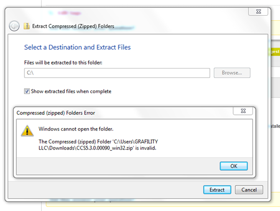

I've been trying to install the latest version of Code Composer Studio (ccs_setup_5.3.0.00090.exe) for a college course I'm taking but keep getting the following error:
http://software-dl.ti.com/dsps/dsps_public_sw/sdo_ccstudio/CCSv5/CCS5.3.0.00090_win32/featurerepo/binary/
An error was detected while performing the engine operation and the changes are being rolled back. See the log for details.
Installation failed.
The installer continues after a while, but then reaches the same error.
I have tried to download the offline zipped version of the program several times, but it never extracts! I even downloaded previous versions of the program
but those don't extract either. Even the online installers don't work. They advance but  fail about halfway through the installation.
I have disabled my antivirus and run the installers as administrator. I also check to make sure the directory is C:\ti.
I even tried to install CSSv5 in another account on my laptop but that doesn't work either!
I am using a Windows 7 64-bit PC.

  • Hi Lisa,
    Thanks for your quick response. After my last post, I tried another download of the CSSv5 offline zip file (CCS5.3.0.00090_win32.zip) and
    it still didn't unzip. I get an "invalid file" error despite me trying to extract the file to C:\
    The file is about 1.32 GB.
    If by junctions you mean that my C directory links to another one, then no there are no junctions. I have tried to install or extract everything directly on
    my C directory. I even moved the zip file to the C directory and tried to extract from there (just in case) to no avail.
    All of my CSS offline zip downloads just don't extract, even the previous versions (eg CCS5.1.1.00031_win32.zip).

  • Hello Lisa,
    Pretty strange right? I moved the file to c:\ but I still get the same error. I also downloaded 7-zip and tried extraction with that but it also failed.
    I tried downloading the files before at different times during day  but its all the same.  I do know that some of my lab mates have been unable
    to install CSS5 as well.

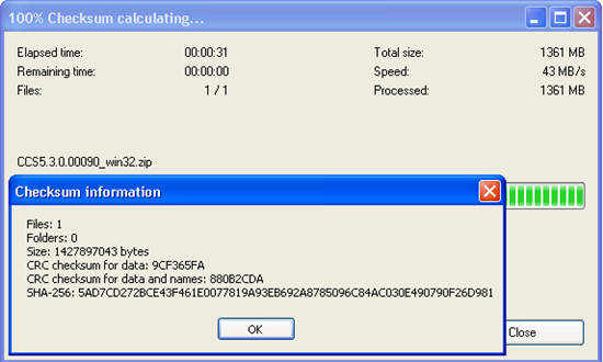

  • Gerry
    Since you have downloaded the zip file for 5.3 (more than once!) and also have , the first thing I wanted to check is whether the zip file is complete. Using the file->calculate checksum option in 7zip, here is what I get for the 5.3 zip file. Does this match your results?
    My suspicion is something on your PC is blocking access to certain files during installation. I know you have disabled your AV program, but I was wondering which company's AV you are using and whether you have any other anti adware or anti spyware software installed?
  • Hello Andy,
    Thanks for the reply. For some reason the checksum with 7-zip doesn't work (even though I'm the admin). I did use two other utilites and got the following results:
    SHA-256:   84ce72f084de15e67975103f4293d6e944be2be6166e46b2456dcd2e05cb0be8
    MD5: 146a3d57127ba23bf8c2e4e17da0462b
    CRC32: 533299f0
    The file size is: 1427883507 B
    It seems the file size is LESS than what you have, so the checksums don't match. This could be why the file doesn't extract, but I have no idea what is causing the loss. The only AV I have is Bitdefender Total Security 2013. My laptop is new so I haven't installed any other AV.
    I am using cable internet and downloading the file over wireless. Maybe that is the cause of the loss? I will try to redownload the file over ethernet and see if that helps (or if I get a different file size!).

  • Andy and Lisa,
    I redownloaded the file over Ethernet and that worked! I verified the checksum of the file and they match your results. I was able to successfully extract (and install)
    the program.
    It makes sense that there would be packet loss over WIFI,  although I didn't really expect that to happen when downloading files (especially after paying so much for internet service).
    I might presume that potential file size loss could be a cause of installation issues for laptop users or those downloading through a wireless network.
    Your assistance was greatly appreciated. Thank you so much.
    Gerry
