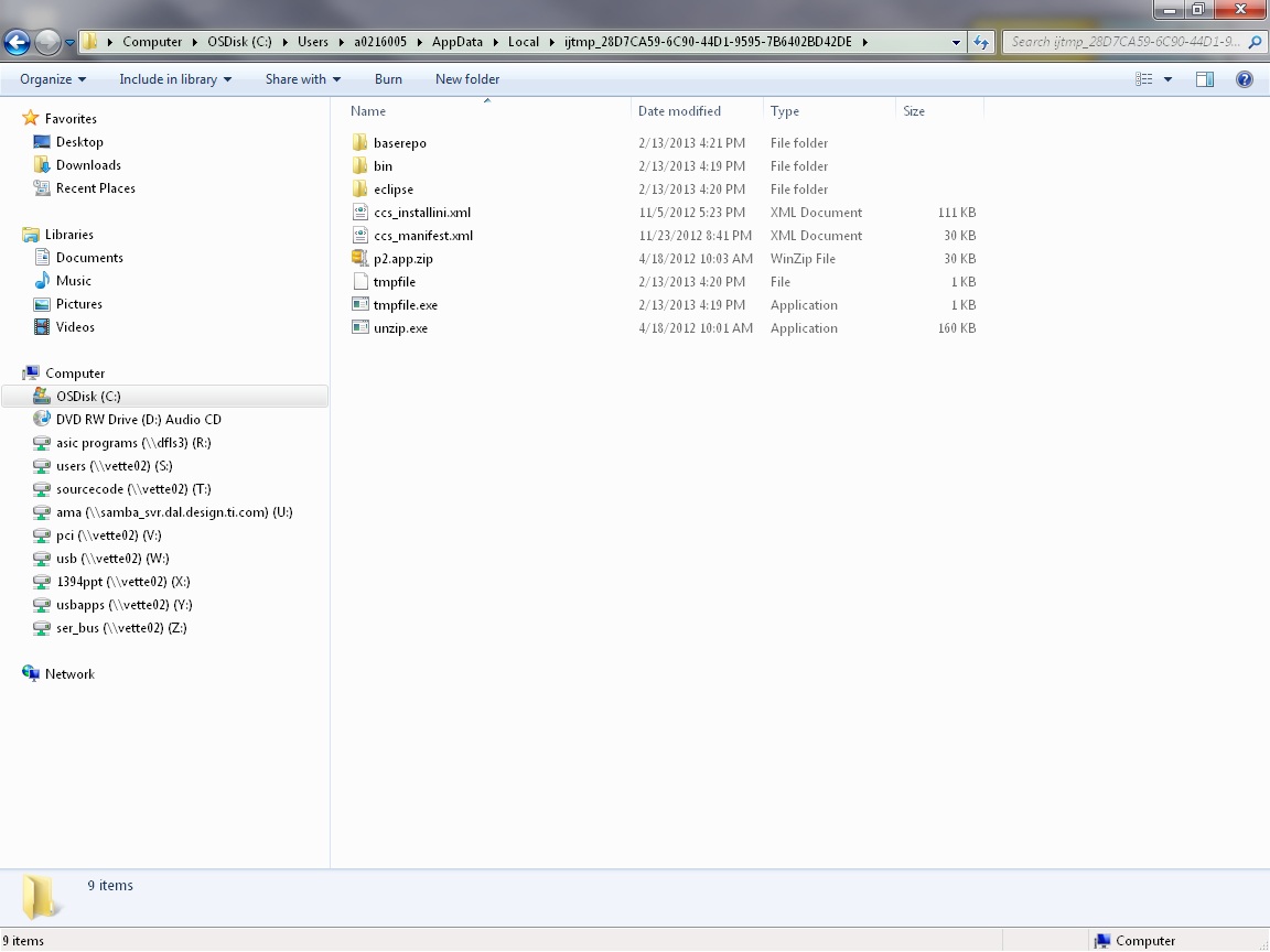

  • Lisa
    Please see the screen capture of the file directories. I am using Win7, not Win XP.

  • Hi David,
    It looks like the unzip.exe was correctly extracted. I'm not sure why it can't run on your machine and I was wondering if you'd be willing to try running the executable on the command line so we can see if it's something on your machine that's causing the failure?

  • Danish
    Both C:\CCSV5\ccsv5 and C:\Users\a0216005\Appdata are directories only, not junction.
    Please see attached screen capture, the unzip utiliy manages to unzip the file without any error message.
    In Win 7, the directories ijtmp_28D7CA59-6C90-44D1-9595-7B6402BD42DE resides under c:\users\a0216005\appdata\local, not C:/Users/a0216005/LOCALS~1/Temp, will this be the problem?

  • Hi David,
    That's exactly what the problem is - there seems to be a disconnect between what it thinks the TEMP directory is and what it actually is.
