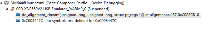

Debugging Linux kernel with ccs5.3
Debug host: win7 64bit, ccs5.3, compile workstation: vmware running centos 6.3
target: EVMDM6446, emulator: xds560v2 type emulator (SSD-XDS560v2 Plus)
u-boot &uImage burned in flash,vmlinux compiled with debug info(size 42M)
Following instructions found in an old post http://e2e.ti.com/support/development_tools/code_composer_studio/f/81/t/114583.aspx
Now i can break at start_kernel with H/W breakpoint. But neither H/W or S/W breakpoint can break at schedule.
Any clues? Thanks!
