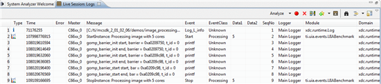

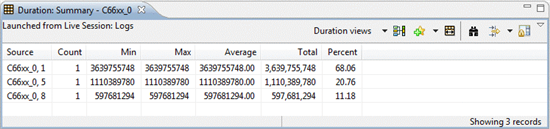

  • Hi Paula,
         You need to use UIA 1.2.1.8_eng or later  (we’ve made this engineering publicly available at http://software-dl.ti.com/dsps/dsps_public_sw/sdo_ccstudio/UIA/OpenMP/uia_1_02_01_08_eng.zip  - since it’s an eng release, we’re not publishing it widely, but just to E2E forum users that need it).
    This fixes a race condition that is present in single image programs where cores try to register their loggers in a linked list headed by a global variable pointer.  The behavior you discussed is consistent with this bug, since it can cause cores to get stuck in a loop in the registration code.
    I've verified that, with UIA 1.2.1.8_eng, you can use JTAG run mode as a transport to upload events from the Main application code using this UIA release and the mcsdk openMP image processing demo from MCSDK 2.1.2.6, CCSv5.2.1.00018 and v7.4.0 C6000 compiler, using the same steps you described.
    Here's the .cfg script you need to add:
    var Log = xdc.useModule('xdc.runtime.Log');
    var UIABenchmark  = xdc.useModule('ti.uia.events.UIABenchmark');
    var LoggingSetup = xdc.useModule('ti.uia.sysbios.LoggingSetup');
    LoggingSetup.loadLogging = false;
    LoggingSetup.mainLoggerSize = 8192;
    LoggingSetup.sysbiosTaskLogging = false;
    LoggingSetup.eventUploadMode = LoggingSetup.UploadMode_JTAGRUNMODE
    var Main = xdc.useModule('xdc.runtime.Main');
    var Diags = xdc.useModule('xdc.runtime.Diags');
    Main.common$.diags_STATUS = Diags.ALWAYS_ON;
    Main.common$.diags_ANALYSIS = Diags.ALWAYS_ON;
    Main.common$.diags_INFO = Diags.ALWAYS_ON;
    Main.common$.diags_USER1 = Diags.RUNTIME_ON;
    Main.common$.diags_USER2 = Diags.RUNTIME_ON;
    Main.common$.diags_USER3 = Diags.RUNTIME_ON;
    Main.common$.diags_USER4 = Diags.RUNTIME_ON;
    Main.common$.diags_USER5 = Diags.RUNTIME_ON;
    Main.common$.diags_USER6 = Diags.RUNTIME_ON;
    I've attached the master_main.c file with some UIABenchmark events logged at the start and end of the image processing - these can be viewed in the Duration analysis view for comparisons of the amount of time it takes to process an image with N cores.

    I find, however, if you set LoggingSetup.sysbiosTaskLogging = true, then you get the following error on occasion when using more than one core to process the image:
    C66xx_0: Trouble Reading Memory Block at 0x821368 on Page 0 of Length 0xe30: (Error -1060 @ 0x821930) Device is not responding to the request. Reset the device, and retry the operation. If error persists, confirm configuration, power-cycle the board, and/or try more reliable JTAG settings (e.g. lower TCLK). (Emulation package 5.0.747.0)
    This address is the read pointer for the LoggerCircBuf logger used to log SysBios system events.  I'm not sure why this error is occurring.  I also have not been able to get the events uploaded via UDP yet - does the customer require this?
       Brian
  • Brian, thanks a lot for your help, I am not aware if they require events via UDP, I will ask them and let you know
    Thanks again,
    Paula
    I have followed the instructions from BrianC on the e2e webpage.
    The following is what I did and the problem I encountered:

        Log_info0("Mailbox creation successful. About to enter main while loop...");
        while(1) {
            if (Mailbox_pend(master_mbox_receive, &process_msg, BIOS_WAIT_FOREVER) == FALSE) {
                System_printf("main: Mailbox_pend returns error\n");
                return 0;
            Log_write2(UIABenchmark_startInstance,(IArg)"Processing image with %d cores",(IArg)process_msg.number_of_cores);
            response_msg.result = mc_process_bmp(process_msg.processing_type, &process_msg.input_image,
                                &response_msg.output_image, process_msg.number_of_cores,
                                &response_msg.processing_time);
            if (Mailbox_post(master_mbox_send, &response_msg, BIOS_WAIT_FOREVER) == FALSE) {
                System_printf("main: Mailbox_post returns error\n");
                return 0;
            Log_write2(UIABenchmark_stopInstance,(IArg)"Processing image with %d cores",(IArg)process_msg.number_of_cores);

     which eliminates the warnings - the parameters to the Log_write2 macros are cast as IArg . I've also added an event before entering the main while(1) loop after the mailboxes have been successfully initialized.  On my setup, this event appears in the Live Session: Logs view around 10-20 seconds after the IP address is displayed in the console window.
    Note that events are logged at the start and end of the processing of each image, so you will not see any more events displayed in the Live Session: Logs view until after each image has been fully processed and displayed in the web browser.
    Steps:
    - ensure the .ccxml launch configuration has the C66xx_0 initialization script setting configured to run the ccsv5\ccs_base\emulation\boards\evmc6678l\gel\evmc6678l.gel file
    - if you have a debug session already in progress, terminate it
    - launch the target and connect only to core 0
    - with core 0 selected, apply a system reset (from the CCS main menu: Run / Reset / System Reset)
    - load the project.  It should run to main.
    - start System Analyzer while the target is halted and at main.  (Tools / System Analyzer / Live -> Start)
    - run core 0
    - open a web browser at http://<IP address displayed in the console window>
    - in the web page, select number of cores to use, image to process, click the Process button.
    Here's a screenshot of what you should see after you have processed an image:
    You can then click on the word Analyze in the toolbar and select "Duration" to see a table with info on the amount of time it took to process the image.  Each time you select a different number of cores to process the image, a new line will be added to the table.  The second value in the "Source" column indicates the number of cores used to process the image.
    Does this work on your setup?

  • Thanks Brian,
    That worked. So I went back to the earlier version of mcip_master_main.c (with the warnings) and that works too. I think I must have got my sequence of steps wrong but now I get the logs as you do with both versions of mcip_master_main.c and the sequence of steps that you outlined.
    - Shiv
  • Hi Shiv,
      That's great!
    We're introducing some improvements to System Analyzer's JTAG transport in CCSv5.4 which will make the sequence of steps less critical - it has been updated to cope with targets where initialization has not yet finished or the target has already started running.  For CCSv5.2 and v5.3, however, you need to ensure that the target is halted at main when System analyzer is started up to ensure that initialization of the logger data structures is complete and the target is not running.
      Brian
  • Hi Brian and Paula,
    I have followed Brian's instructions and the process went smoothly. Everything worked as described and I can add my own SA commands for more analysis.
    Hi Paula, I have noticed Brian 's experiment was based on mcsdk-2.1.2.6; and i was using mcsdk-2.1.2.5 and pdk-1.1.2.5, but I naively assume that shouldn't make a difference. Of course, it was my mistake.
    I will move onto our own image processing codes and hope they will work just as well.
    Thank you very much for the help from both of you.
    Wing
  • Wing, Shiv thanks for your confirmation. Brian, thanks for your help
    Paula
