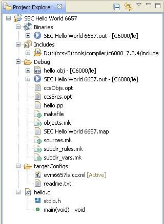

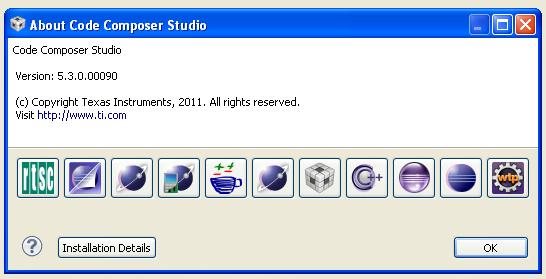

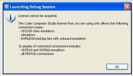

I have just done a clean install of the EVM6657LS DVD including CCS5, created a project using the supplied "hello world" program and "evm6657ls.ccxml" which is clearly included as part of the project in the "target configs" folder and is marked as "active". The CCS5 license manager says I have the "free license". The project compiles without error, but when I press "Debug" I get the message "License cannot be acquired" and the license status changes to "not licensed". I can use the license manager to create a new "free license", but the problem repeats when I press "debug".  I went on to do a full update of CCS5 and this problem is unchanged.

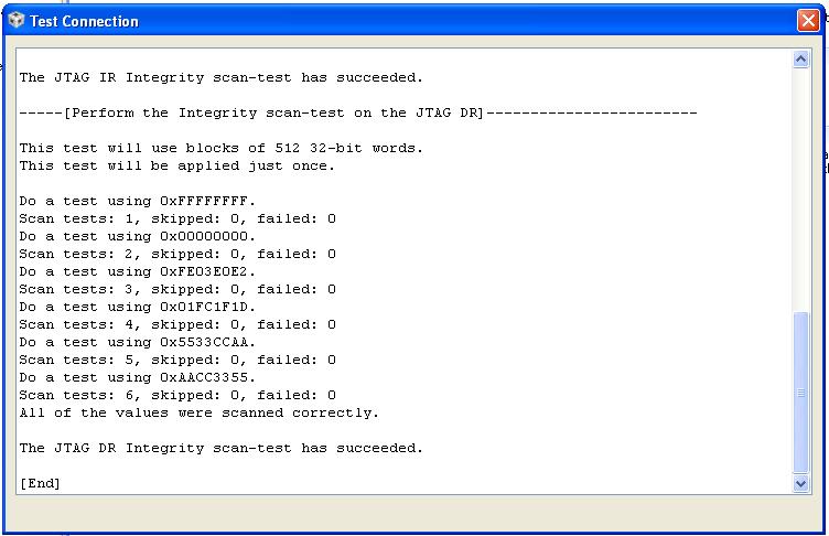

The EVM6657LS is connected with the USB cable plugged into J1 on the XDS2xx mezzanine, and if I open the evm6657ls.ccxml and press "test connection" I get the message "test succeeded".

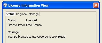

    I went to the license information view where it said "unlicensed".
    I went to the upgrade tab and launched license setup
    I clicked on the "free license" option,pressed finish and status changed to licensed.
    I pressed "debug" with project as described before, and after a little activity received the message "license can not be acquired"
    So no change.

    Afterwards the status report was "license type: free license"
    I have attached a screen shot of the license manager file list with the location of the free license I just created highlighted, in case that helps.
    Pressing debug resulted in the same failure to acquire a license message.

    The debug operation then ran to completion and the license problem is solved, so thank you very much for your help.
    I think all EVM users would be very grateful if TI could widely publicise the following paragraph:
    In release 02.01.01 of "Multicore Software Development Kit", and possibly other releases, the supplied EVM6657LS.CCXML, and possibly other EVM   .CCXML files, only have the connection "Texas Instruments XDS2xx USB Emulator" defined in them. This connection prevents the use of the supplied Code Composer free license. The connection "Texas Instruments XDS2xx USB Onboard Emulator" is required in order to use the supplied Code Composer free license. The supplied EVM6657LS.CCXML must be opened and the connection changed manually.

    It was especially subtle because the XDS2xx JTAG connection test works correctly, even though the connection type is wrong, so only the free CCS license fails.
