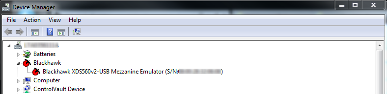

 7. Using Blackhawk Control Panel to "Reinstall All...". I can  only see the emulator if I tick "Show all devices". When I try to update I get a error popup saying: "Update driver failed! Error: Access is denied. [OK] [Cancel]". Furthermore in this utility I cannot see: "Serial Number", "Board Type", "Hardware Revision", "Firmware Revision". What I do see is : "PnP Device ID: USB\VID_0B1E&PID_0009\08:00:28:32:06:08".

  • Cristian,

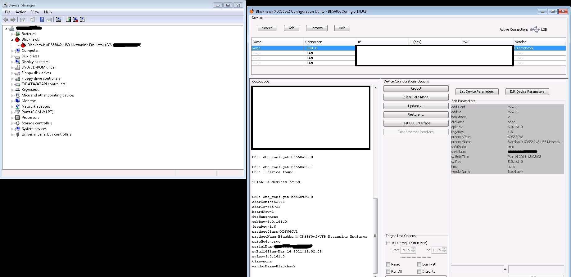

    Did you try to perform the tests using the Bh560v2 Config Utility? Does it show something similar to the screen below?
    Also, are there any errors reported by the Windows Control Panel?
    Sometimes the USB port plays tricks on the attached devices, especially if they are connected through HUBs.
    Rafael
  • Hi Rafael,
     Note that in our setup we have VMware virtualization and the Windows 7 host is actually a VM. However, we have dedicated USB ports for each VM and we have not had this problem with other identical setups (i.e. we have another evm6678 pg2 that's working fine).
     Now, regarding your questions, here's the information I've seen. There are no errors in Control Panel -> Device Manager.
     With your suggestion I've looked closely at all values and saw that it was in safe mode (for an unknown reason). I've used the BH tool and reset that safe mode option then reset the probe itself.
     I was then able to connect in CCS v5. Thanks!
    BR,
    Cristian
  • Cristian,
    Thanks for reporting back your findings; the Safe mode sometimes becomes active if the emulator detects something wrong in its surroundings - i.e. if the power supply or the JTAG connection have a non-critical malfunction. On my end I have seen this become active when I connected it to a USB HUB that lacked enough power to drive it.
    Rafael

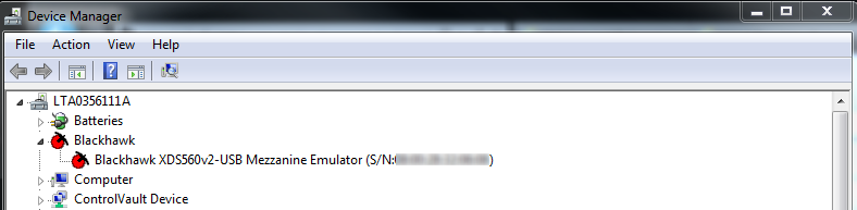

  • I have a similar problem when trying to connect to the XDS560v2-USB emulator, I get the error message
    Error initializing emulator:
    (Error -2083 @ 0x0)
    Unable to communicate with the emulator. Confirm emulator configuration and connections, reset the emulator, and retry the operation.
    (Emulation package 5.1.114.0)
    I presume this is because there is no device driver installed (device manager says there is no driver installed).The BH utility output is given below.
    I cannot find any driver to install either in the installed  CCS folder or on the supplied CD.
    Any suggestions appreciated.
    Best regards
    Alex Bienek.

  • Where can I find this config utility? My installed set of Blackhawk programs only consists of Control panel and LAN config.
  • Ok I see that it is in C:\ti\ccsv6\ccs_base\common\uscif and if you want to update the firmware of mezzanine card when forcing it out of the safe mode does not work, then use firmware from C:\ti\ccsv6\ccs_base\emulation\Blackhawk\Bh560v2\firmware
