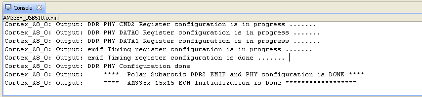

    Hi Mandeep,
    I have created a new project  as specified in the link.
    and I have checked the console IO in console-
    But i am not able to see that "printf". Am i checking correctly here?

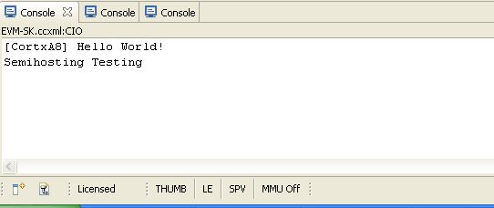

    I am able to see console using evm-sk with xds100v2 emulator.
    This is simple application with printf and puts-
    #include <stdio.h>
     * hello.c
    int main(void) {
          printf("Hello World!\n");
          puts("Semihosting Testing");
          return 0;
    Console output window,-
