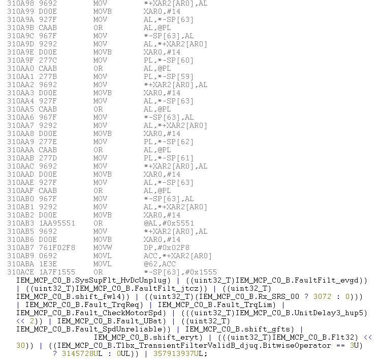

  • Statement wich leads to wrong ASM code:
    SysSup_Fault2 = (((((((((((((((IEM_MCP_C0_B.shift_irm4 | IEM_MCP_C0_B.SysSupFlt_HvDcUnplug) | ((uint32_T)IEM_MCP_C0_B.FaultFilt_evgd))
    | ((uint32_T)IEM_MCP_C0_B.FaultFilt_jtcz)) | ((uint32_T)  IEM_MCP_C0_B.shift_fwl4)) | ((uint32_T)(IEM_MCP_C0_B.Rx_SRS_00 ? 3072 : 0)))
    | IEM_MCP_C0_B.Fault_TrqReq) | IEM_MCP_C0_B.Fault_TrqLim) | IEM_MCP_C0_B.Fault_CheckMotorSpd) | (((uint32_T)IEM_MCP_C0_B.UnitDelay3_hup5)
     << 2)) | IEM_MCP_C0_B.Fault_UBat) | ((uint32_T) IEM_MCP_C0_B.Fault_SpdUnreliable)) | IEM_MCP_C0_B.shift_gfts) |  IEM_MCP_C0_B.shift_eryt) | (((uint32_T)IEM_MCP_C0_B.Flt32) << 30)) | ((IEM_MCP_C0_B.Tlbx_TransientFilterValidB_djuq.BitwiseOperator == 3U) ? 3145728UL : 0UL)) | 357913937UL;
    If I insert the above statement 2 times in the C code the generated ASM code is correct!

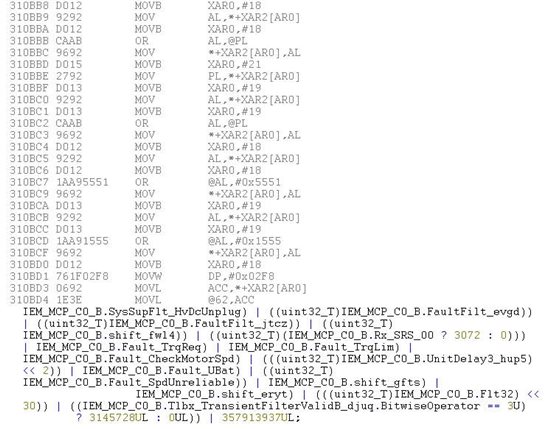

    Compiler 5.2.11 NOK:
    0x310ABA: Result is saved to SysSup_Fault2 (@62)
    0x310ACE: OR with 0x1555 is done after Result is saved to SysSup_Fault2 (Compiler Bug!)

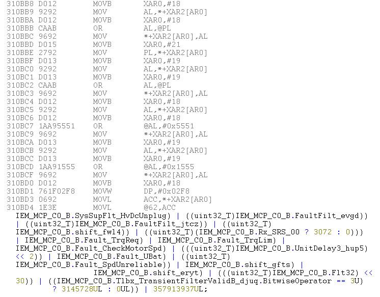

    Compiler 5.2.12 OK:
    0x310BD4: Result is saved to SysSup_Fault2 (@62) after OR with 0x1555 (This is OK)
