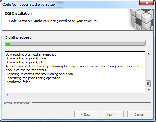

  • It seems I have a similar issue, but I am unsure? I followed the suggestions in this post; however, I have been unsuccessful with installing CCSv5.5. The Eclipse installation still fails.
    I have attached a couple of snapshots along with the latest log file. This log file was created when running the installer as Administrator.
    Am I missing something, or is this new?
    Any help with this matter would be greatly appreciated. Thanks!
    Brad
    5140.ccs_setup_5.5.0.00077_install.log
  • I just turned off the McAfee real-time scanning. This seems to be the problem.
    I apologize for the post!
    Brad
