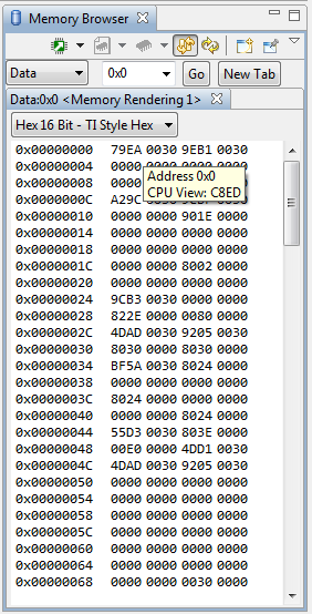

We played a little bit with Memory Browser in Debug session of  CCS 5.3. We were testing it with C2000 code.
The date in the memory should be same as on that picture1. Yellow box is from mouse coursor, that isn't visible on that screeshot, but yellow box show proper value of that memory address (and same value that is in the table).

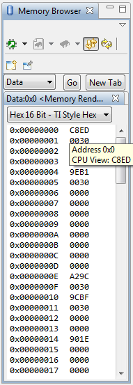

If I resized browser little bit I got different numbers (picture2).  79EA that was on address 0x02 before is now on address 0x00. Address of others data had shifted too.
If I had active 'continous refres' (like on the picture) and point cursor to number under addres 0x0, I get right number in yellow box, but in table is still wrong number from address +0x02.
Can you invoke it on yours computers too?
