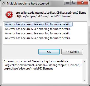

I'm currently using CCS 5.2.1.00018 and I'm getting the below every time I open a project C source file.
How do I eliminate this?

Hi Mark,
my first comment would be to move to the latest version (fresh installation no updates) which is 5.3.
Having said that ... have you tried a fresh workspace? Do I understand correctly you see this with every project and workspace?
Would you be able to enable logging and send us any error logs generated? This wiki goes over troubleshooting.

Hi Mark,
great, very glad that did the trick and sorry for the inconvenience. Nice to chat and thanks for the update.
