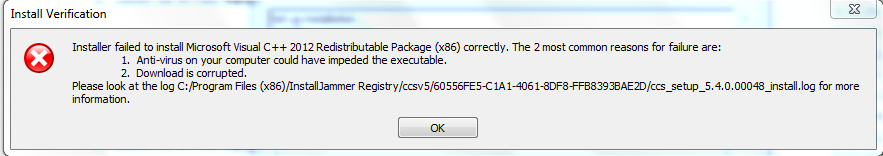

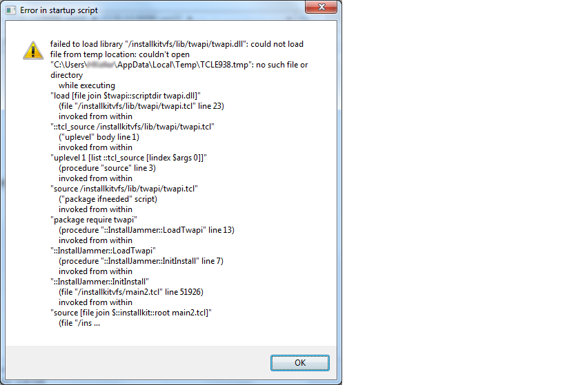

I have trouble with the full (offline) installer of the CCS 5.3.0, to program a MSP430G2553 device. When I will start the installer I got an error (picture).  I have a Windows 7 64 bit system with three partitions.( One for system, programms, data). Please can you help me? I watched for hours in serveral bloggs but no result. I only know that there could be problems with a differing installing location... I have no idea how to solve this?

  • Hi Hendrik,
    could you please send us the installation logs?  These will be found in the installjammer registry directory which is a possibly hidden folder in program files or program files(x86).
    These will tell us the story (or hopefully will).
    Some common issues
    - antivirus or permissions interference
    - use of junctions/mapped/virtual drives or servers
    - use of program files to install
    - special characters in a user name
    Lisa

  • Hi Hendrik,
    CCS 5.3 does not install correctly if the user's using junctions either in their home directory, their temp directory or the install directory. To get around this you need to:
    1. set TMP and TEMP variables from control panel to a writable directory that already exists and that you know doesn't have any junctions or links in the path.
    2. Clean out the install directory completely (a delete will do)
    3. Use CCS5.4.0 beta
    Please let us know if you still have problems.

  • Hi danishinnis,
    I tried it again with your three step instruction ... and it works :-)
    I think I have made a misstake by setting the TMP and TEMP variable.
    Thanky you very much and best regards!
    Lucky Hendrik
