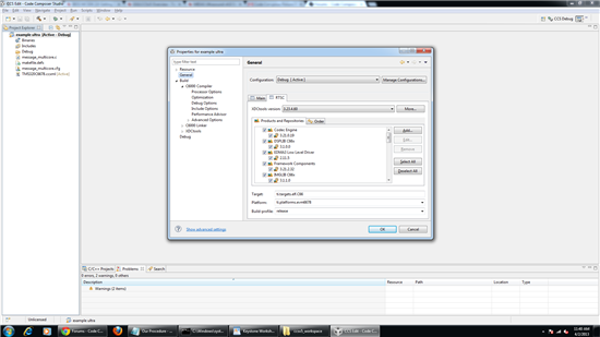

     I am working on TMS320C6678 to build and load the .out file for example given for TMS320C6678. And  I am new to this EVM. I am following steps  http://processors.wiki.ti.com/index.php/BIOS_MCSDK_2.0_Getting_Started_Guide. According to the guideline I installed CCStudio on my windows pc and after that  I installed BIOS MCSDK which are provided with DVD. If I build the any example program I am getting error as xdc.tools.configuro:Error :Can't find  platform package ti.sdo.ipc.examples.platforms.evm6678.core0.
          I installed CCStudio by the installer  ccstudio_5.2.1_win_32 which is provided in DVD . But I am getting license problem . The given CCS is not provided with any license,how to license for it.Is the erroe I mentioned due to the license problem?

    The error
    is about the platform you're using. The platforms contains informations about CPU clock, memory map... The platform you're using is chosen in Right Click on your project -> Properties -> CCS General -> RTSC, then you choose the produscts versions, the Tarrget and the Platform. Can you post the print of these options? Maybe you don't have something installed or it's just a version problem.
    Thank you, now I am not getting mentioned error.I added  the product versions,the target and platform as below mentioned snap shot .
