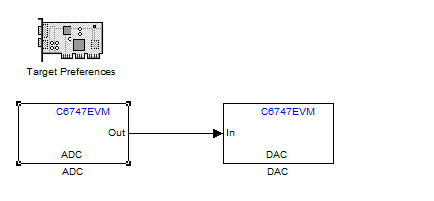

  • Thanks for your reply.
    When I use Code Composer to 'Load Program', is the program not loaded onto the DSP's internal memory? How do I find out where my code is being placed?
    I am using Simulink to generate code for this board to avoid handwriting code. Could that be why the latency is so high? I would think not, since Simulink Embedded Coder supports many TI boards and there would be no reason to make realizing a real time system so difficult.
    Here is the simple ADC -> DAC audio system I made in Simulink:
    I do not understand how such a simple system can have such an unacceptable number of profile clock cycles.
    Would Simulink really generate code in such a way that makes the processing super inefficient??
    Thanks.
    Not necessarily. CCS will read the symbolic information in your out file to figure out where to load it. It is the linker that allocates where your program gets loaded to memory (and from where to run from). You can control the placement of this code using a linker command file (*.cmd file).
    Linker command files are covered in detail in Section 7.5 of the Assembly language user's guide:
    http://www.ti.com/lit/ug/spru186w/spru186w.pdf
    A summary is mentioned here: http://processors.wiki.ti.com/index.php/Troubleshooting_CCS_-_Data_Verification_Errors#Code_Generation_Tools
    Sorry, I have little experience with Simulink. That question may be best asked to Mathworks support.

  • Hi again.
    I have been fooling around with the Target Preferences block in Simulink which seems to have options to control where sections are placed in memory.
    I have placed all the sections I could select (.text, .cio, etc.) into IRAM. The only section I have been unable to place in IRAM is the .far section.
    I tested the Cycles per iteration of the simple audio ADC->DAC model and there was some improvement (from 40K-100K to now 30K-50K) which still does not meet the requirements for a real time system. Here is my question:
    Is there anything else I can do to make the processing faster?
    For reference I will paste a picture of the Simulink interface that controls memory placement the contents of the *.tcf file.
