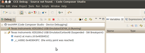

I created a CCS project for C6000 compiler and would like to debug it. According to http://processors.wiki.ti.com/index.php/Connecting_to_DSP_on_C6A8168,_DM8168,_DM8148 I create a project for ARM, launch debug session, load GEL file, do Scripts->TI816X CPU BRINGUPS->C674x. From here I don't quite understand how to debug my project for C6000. I can load ".out" file to DSP, core TI XDS100v2 USB Emulator/C674X_0 turns into running state, but I don't see how to launch my program or use some debugging options (step by step, f.e.)
I use CCS 5.2.1, EVMDM8168 and XDS100v2 simulator.

  • Hi Lisa,
    Thanks for reply.
    When I load ".out" file on DSP, these buttons (resume, step into, step over etc) become unavailable. This file was compiled from CCS project for C6000 in debug mode.

  • Hi Sergey,
    I see in your screen shot your are running.  Hit pause and the other buttons should no longer be greyed out.

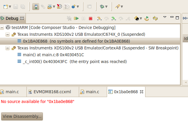

  • Yes, they are, but I get "No source available for "0x1ba0e868" error and still can't invoke my code for debugging.
    It looks like it doesn't enter into main() function and I need to do something else to launch program.
    Sergey.
  • Hi Sergey,
    I don't think you are necessarily doing anything wrong, but may need to point the debugger to the source.
    The message is saying that the debugger cannot find the source file for this function. It might be from the run-time support library, of whose sources files are normally not known to the debugger. You will usually see this when you break in any code from the run-time library ( like at the entry point of your application (c_int00) and the exit point or abort routines).
