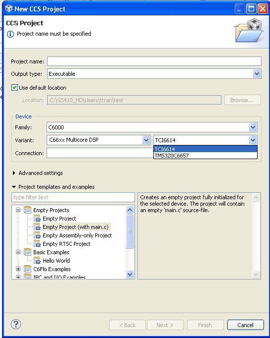

I install new CCS v5.3 and when I create a new project, there is no device C6678 as selection. did I do some thing wrong?

Yes, I create the ccs project and select C6000 and then C66xx and in that, it has only C6657 and nothing else. do I need to install anything else on top of the ccs_v5.3 file that I download from the TI website?

Could you possibly send a screen capture? Would you be able to check for permissions/antivirus issues?

I think I know what may be happening in your case: there is an issue with the C66x package that shipped with the standard CCSv5.3. To fix that, open the updates (menu Help --> Check for Updates) and you will see a package named Keystone version 1.0.6.0.
I installed it in my CCS and the processors started to show correctly. Check the attached screen.

when I tried to updated the software, I got the following message and also see the attached
An error occurred while collecting items to be installed
session context was:(profile=epp.package.cpp, phase=org.eclipse.equinox.internal.p2.engine.phases.Collect, operand=, action=).
No repository found containing: org.eclipse.update.feature,com.ti.emulation.keystone1.win32,1.0.6.0
No repository found containing: binary,com.ti.emulation.keystone1.win32_root,1.0.6.0

I suspect my colleague Rafael is correct in that you need a newer keystone emulation package. The question now is how to bring that in for you.
