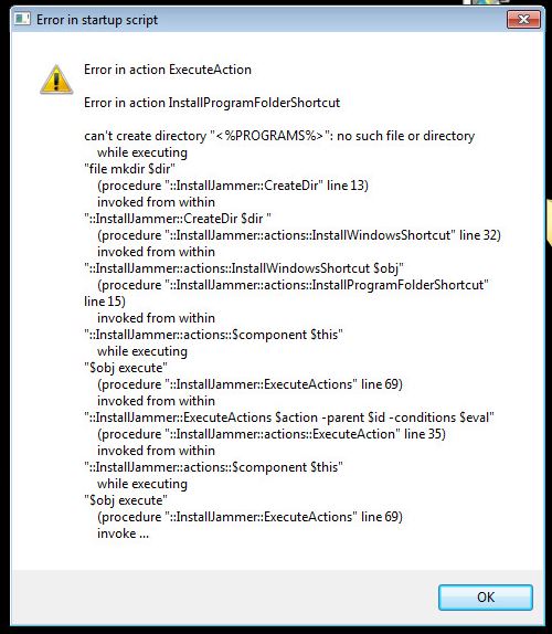

when I install the SDK with mode silent I get the following Error messages
it happens on the following components:
IMGLIB 3.1.1.0
DSPLIB 3.1.1.1
MATHLIB 3.0.1.1
SYSLIB 2.0.7.1
It only happens when it is installed remotly as SYSTEM
Any solution for this?
  • It seems like a permissions issue. Can you elaborate on how you invoke the install? Specifically, how do you run the installer to install it "remotely as SYSTEM"? Thx.

    Could you please zip up the contents of c:\program files\installjammer registry\ccsv5 and attach them here? If you're running on 64 bit windows, the folder will be in "program files (x86)". It's a hidden folder and you may need to unhide it from explorer.
    I need to look at the logs to verify, but it looks like your installation was completed successfully, even though it wasn't able to update the shortcuts.Your logs will also help us fix the problem for further releases.

  • first the dir after ccs5 installation
    I now get a similiar error when installing just ccs5.
    maybe i am missing some prerequisites?

  • Hi Patrick,
    Thank you for your patience.
    Firstly, we've released 5.4 beta, which is a lot more robust and gives more information, in case of an issue. I would recommend you try this installer, if possible. You will need to create new response files though as the components have changed.
    I have a few questions for you, that may help us figure out the problem you're having:
    1. Have you unzipped the package completely? i.e. you're not running from within the zip file.
    2. Do you have junctions or links setup in either the the temporary folder where the installer zip is extracted, or in your %TEMP% folder, or in the installation folder?
    3. Could you send me all the *.log files that are in C:\ccs5\ccsv5\eclipse\configuration\?
    Danish Innis
