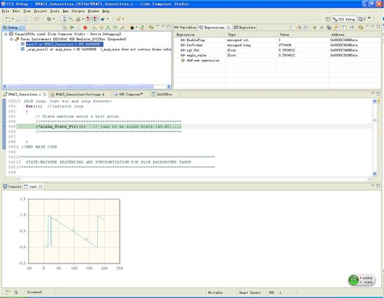

  • Dear Patrick
    I also have some question about GUI composer.
    My target is TMS320F28335. I use CCS5.4. the emulator is XDS100V2. I want to observe 8 variables during the debug process. So I try the GUI composer. I use the “Scalarlinegraph” widget. First I try display only one variable. I utilize a project designed by TI, provided in controlsuite.
    ti\controlSUITE\development_kits\HVMotorCtrl+PfcKit_v2.1\HVACI_Sensorless_2833x
    In this project I bind a global variable rg1.Out to value0 of the scalarlinegraph. This variable is expected to generate a ramp. I set the Buffer Length to 200. However when I run the project, the graph always has some glitch, which should not appear.
     When I change to another computer, the OS of which is WIN7, it is even worse. There is no ramp curve at all.
    I feel confused. I don’t know how to solve such problem.
    Could I trouble you give me some documents that show how to use linegraph widget? I search on the internet, but I can’t find one suitable.
  • Hi Xin,
    It is most likely that the target variable is updating faster than the Scalar graph's update rate. You can change the update interval to a smaller number by creating a textbox widget and bind it to this variable $refresh_interval. The default is to update the widget once for every 1000ms.
    Patrick
