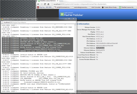

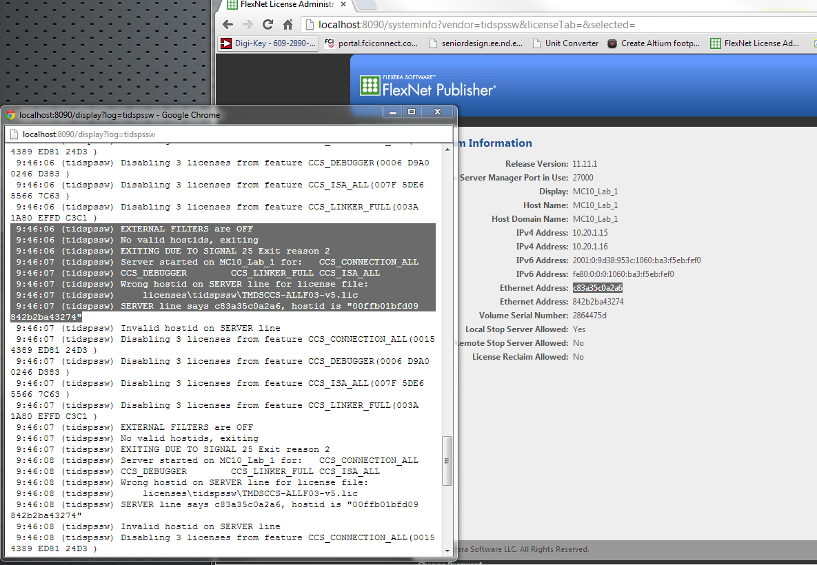

  • I too am experiencing the same problem, but none of the advice offered above has been any help in getting towards a solution.  Our License Server is running on a 64-bit Windows 7 PC.
    Here is the log file produced by Flexnet which provides some strong clues as to the cause of the problem.  Unfortunately, our IT specialist has no prior experience with Flexnet and cannot decipher these clues.  Hopefully, someone at TI can:

    Having said that it looks like the license might have been setup to the incorrect MAC address.  Is is a new license you are just setting up?   Can you verify the servers eth0 address in particular was used to activate the license?
    Lisa
  • Hi Lisa,
    Yes, this is a new license that we are just trying to set up.  How do I verify that the server's eth0 address was used to activate the license?
    there are a couple things:
    1- from a dos prompt ipconfig /all shows you all your setup
    2 - double check you registered with the MAC address that the server was asking for in that message
    If, as I suspect you simply need to rehost, you can do this the first time yourself here:
    www.ti.com/myregisteredsoftware
    Please keep us informed.
    Lisa
  • Hi Lisa,
    Thank you for sharing that link for the rehosting process.  I went through all that and came out at the end with no change in my Error Message.  I also confirmed (via Ipconfig) that the MAC address in the license matches the MAC address of our Server.  Do you have any other suggestions?
  • Hi Matthew,
    can you verify you used the eth0 address specifically?  Also, did you restart the server and vendor daemon/reread the new license file?
    What specific error do you get now?
    Lisa
  • Hi Lisa,
    I had to restart the service from the Windows Services Screen and now Flexnet is up and operating!  Thank you for your assistance.
