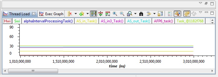

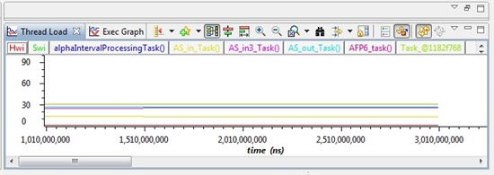

I understand that the RTDX stuff is deprectated. The exec graph didn't work earlier with the RTDX stuff either. The thread load tool works, as you see in the attached.

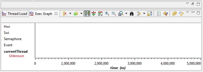

The exec graph tool produces this:
I try to follow the procedure demonstrated in Eric and Scott's video
(http://software-dl.ti.com/trainingTTO/trainingTTO_public_sw/bios_1day_videos/Chapter_5/Chapter_5.html).

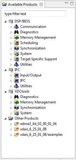

But looking at the available products pane with my pa.cfg open in CCS5, I don't see the Real Time Analysis tab:
I wonder if you can suggest a change to my .cfg file to enable this?
