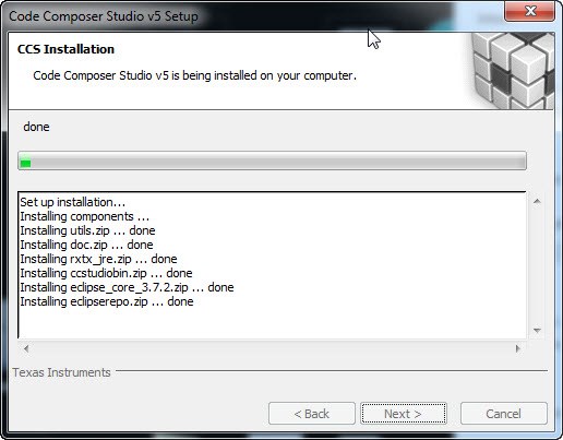

the installation crashes with the following error on my system:
Installation log:

05/06/2013 08:17:51AM - ERROR: Installer failed to install com.ti.ccstudio.debugserver.win32 correctly. The 2 most common reasons for failure are:
    1.  Anti-virus on your computer could have impeded the executable.
    2.  Download is corrupted.
Please look at the log C:/Program Files (x86)/InstallJammer Registry/ccsv5/60556FE5-C1A1-4061-8DF8-FFB8393BAE2D/ccs_setup_5.4.0.00091_install.log for more information.
The system is Windows 7 64 Bit. I tried the web-installer and the offline installer with the same result. The Anti-virus software was deactivated during installation.
The installation on an older Windows XP 32 Bit machine was successful.

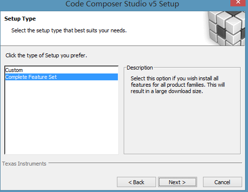

  • hello !Ralf.
    I met the same problem with you.The system is Windows 7 64 Bit. I've never had it installed successfully.  Could you tell me how to solve it? Thank you!
  • Hello zhao,
    the workaround suggested by Danish worked for me.
    After installing CCS you can set the graphics processor back to "Auto-select".
    Ralf
  • Feel shy, I CCS not installed successfully.Installation of my steps are as follows
    Of course, I choose to install the parts I need the same error  Could you give me  some suggestions? Thank you,Ralf!
